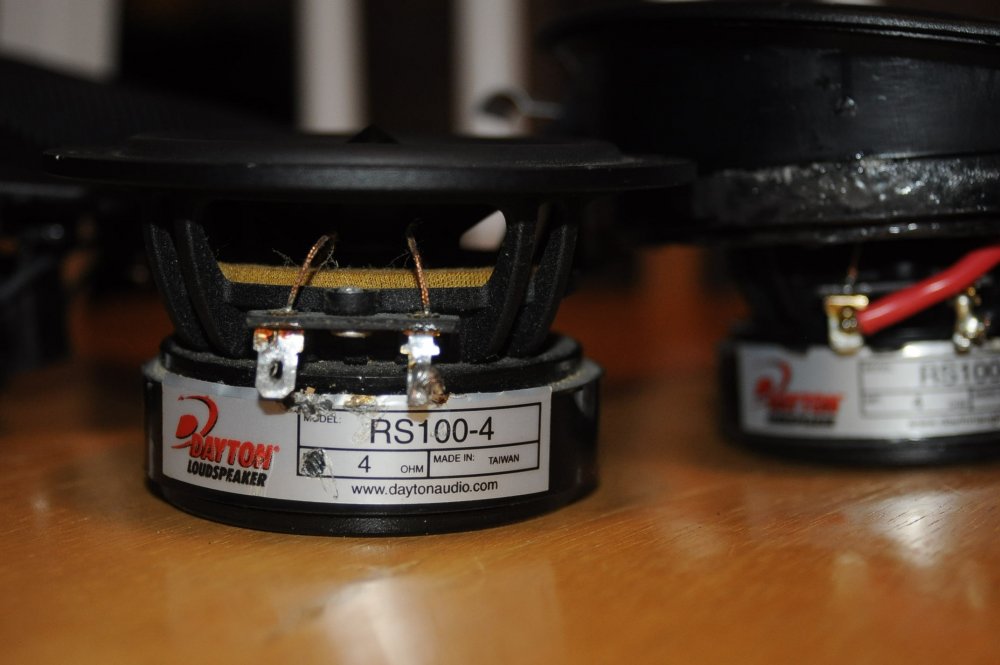

  2. That is a nice write-up! I am buckling up a major Winter project on my 2000 986 (2Din head unit,996 cluster,OBD, piggyback Alarm system). Audio I attached some pics of the speaker direction I went in as choosing speakers was my top priority. My decision process was to : 1) Determine what speakers sounded best , and would fit a. Prepare the car for the auditions (remove head unit, install rear speakers / wires etc) b. Wire a home theater receiver to the speakers for the testing c. Install speakers and listen 2) Now that I decided on speakers, choose amp a. Determine if factory amp (actually now 6x40, same specs) could work with mods b. Test with HT receiver "line out" for proper levels I tested about five different car speakers. None did it for me, I really liked the Dayton RS100-4 but they were too tall,too heavy. I wound up fabricating a substantial mounting mod to make them work. These are the testing prototype pics attached. I used 1/16" plywood for the adapter ring and the housing from the original speaker. The problem with using a speaker like this is that they are much heavier than an auto speaker. So, I basically potted the entire assembly in epoxy for strength, drilled the 6 mounting holes needed for the Dayton, and put it in for final measurements. I have a full 1/4" clearance everywhere and they sound great! More as I have time to write. Next, I will post my mods of the factory amp(s). Jerry Prado
