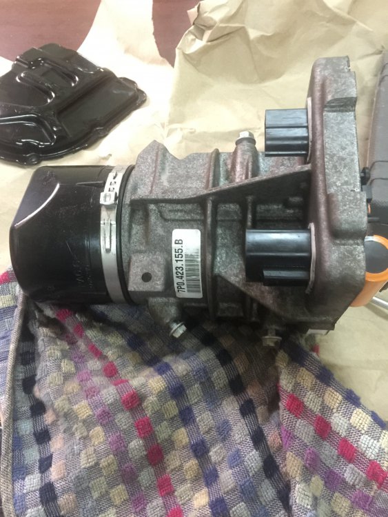

  3. Hi everyone, today i received the Mosfet and replaced the faulty one on the BCM board, after that i reinstalled in place the unit but unfortunately the same thing happening, the E-power steering pump not activated. The new E-pump is not showing up on Piwis, still not detected. Maybe i have to try the old one after repairing the BCM unit? Will give it a try..BTW i noticed that the electronic steering lock is not working too, can’t hear the click noise when switching the keys, and this unit also not detected by Piwis.
  4. Hi, for now i will firstly replace the MOSFET as it will be more easier and than will give it a try, (searching for the parts). If replacing the BCM module it have to be coded with PIWIS to get it work, i have it but maybe it will ask for imo codes?! The cause could be the battery or a short on wires..
  5. Hi, after an hour of work, I’ve reached the front BCM module under dashboard, opened it and at the first look i found a bad transistor? Maybe it’s the problem?
  6. Hi all..yesterday I’ve checked all related fuses, and contacts on the E-pump, all seems good. I managed to replace the steering rack sensor to see if its faulty, still the same the E-pump didn’t start! Next i will check the the front BCM..
  7. Hello everyone, i need your help please. I own a panamera s hybrid 2012, having problem with E-power steering , not working, ordered new one and replaced it, but no success!! At the bigining the fault was “servotronic unit” that i couldn’t find anywhere! When i removed the old E-pump i thought the control unit is inside, don’t know if i was wrong, that’s why i ordered the new one. At this moment Piwis can’t see the new one, front-end electronics fault codes c11005(front-end electronics control unit, function restriction), 80400E(front-end electronics control unit, power steering function restriction), 80410F (power steering, limp-home..I appreciate any help. Thank You
