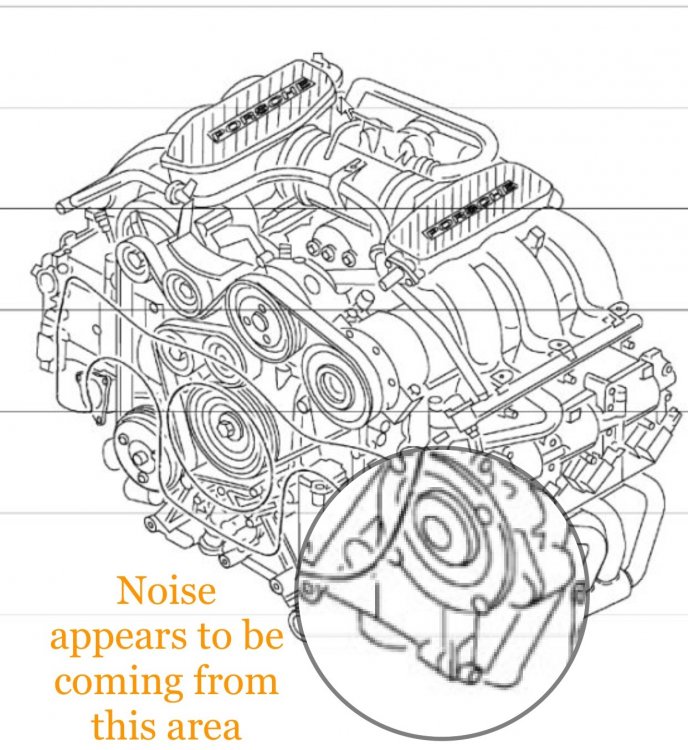

  1. I plan to remove that oil scavenge pump today and have a look at the gear and the pieces inside to see if the keyway has broken off
  2. Also wanted to mention that the car reads between 2 and 4on the oil pressure gauge when hot, and reads 5 at cold start.
  3. Used the stethoscope, it's definitely coming from the engine
  4. And it's very intermittent one minute it will rattle at idle, the next start up it'll be smooth and only make noise when it's reved, sometimes it sounds like the engines going to fall out of the car.
  5. Oil comes out clean no metal particles to be found, the noise is literally coming from the lowest part of the engine on the passenger side facing the bumper.
  6. The noise seems to be coming from the lower front cover of the passenger side
  7. Plugs are all tight. Car has no misfire, no check engine light and develops power.... just the noise
  8. We have listened all over the engine, cannot isolate where the noise is coming from it appears to be coming from under the intake manifold
  9. I've already inspected the airbox and it's not interfering with the belt or rotating assemblies, I'll try removing the belt tomorrow and see if all of the pulleys spin freely.
  10. I also forgot to mention that the sound gets louder with an increase in RPM.
