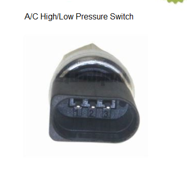

  3. OK, after some more research I can answer more of my own questions. I called an accomplished independent Porsche repair shop in my area and they said that they couldnt adequately diagnose problems with the gateway/CAN bus in my Cayenne S, nor did they know of anyone in the area (Atlanta, Georgia) who could. They very sadly said that I must go to the dealership. They said that the PIWIS systems weren't going to help me much. But, I am not quite convinced. And, I discovered that the 955 Cayenne AC system doesn't have a low / high refrigerant pressure switch like older cars, it has a SENSOR. This sensor has three wires (as seen above). The wire that returns to the "climatronic" control unit delivers a PWM signal that tells the control computer what the pressure is in the line. The computer logic then decides if the pressure is too high or low. So, it isn't a switch that can be bypassed with a jumper wire. Here is a description from a Porsche manual...
