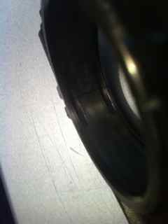

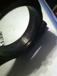

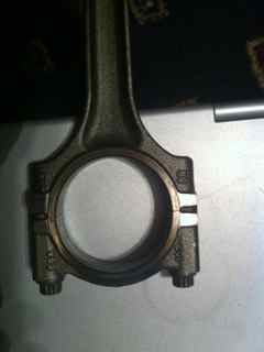

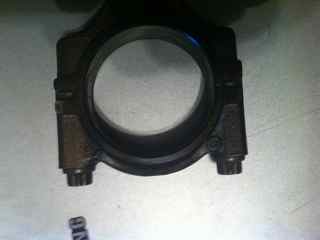

  3. they said they had a porsche engine specialist in to pick up something. the reason they gave is that there is that slight gap that i took a photo of. they said that the rods are stretched because there is that gap and with cracked rods there would fit together with absolutely no gap
  4. Hi I am currently rebuilding my engine after a couple of lifters colapsed. while the engine is out I have had it degreased and steam cleaned. whilst it was in the machine shop they informed me that the con rods were no good and will need replacing. Funnily enough they knew someone that had some for sale. I have taken a couple of pictures of the big end where they said the problem was. The bolts are hand tight and not to torque. please let me know if these do need replacing. The big end shell bearing were very worn. Thanks for your help Ross
