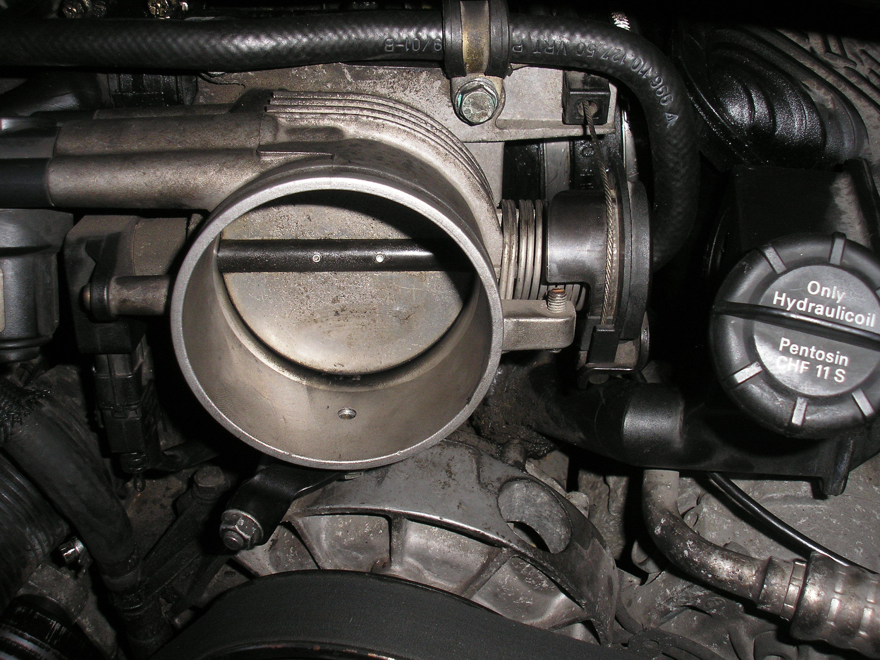

  7. Ok so just changed my stater motor (What a pig of a job) Everything back together but now the car is idling hi, Looking at the photo you can see the flap is open a bit and the cable pulley is not resting on the stop. Should it be? Can anyone see what the problem is?
