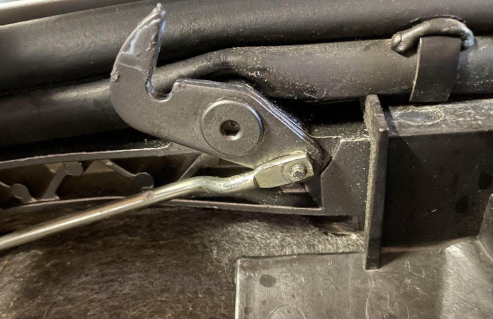

  1. My car is a 2011 911s convertible. I pulled the liner out in the convertible area to lube all of the mechanisms and found that the clamshell hooks were both missing their retaining clips. I found one laying on the paasenger sided, but none on the driver side. I went to the dealer and they are having trouble finding the right p/n. Pictures attached. Is the on that I found corect? I so, what is the p/n so that I can buy another one? If it's not correct what is the correct p/n so that I can buy two. Thanks in advance.
