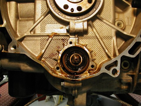

    west virginia, US
    chopped 48 chevy pickup

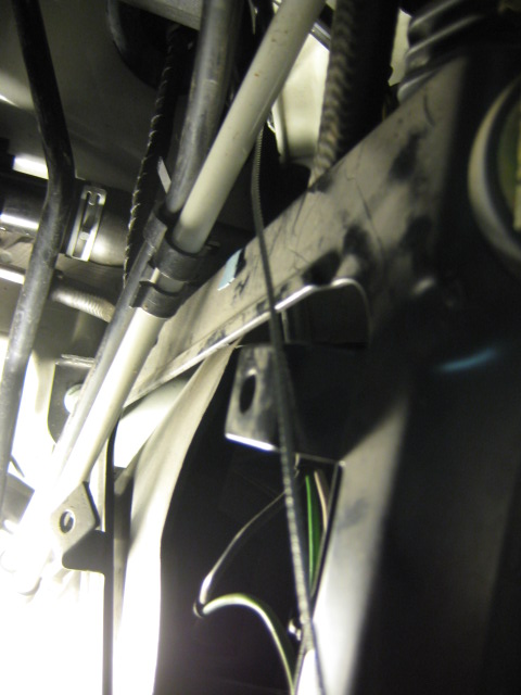

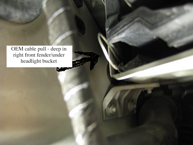

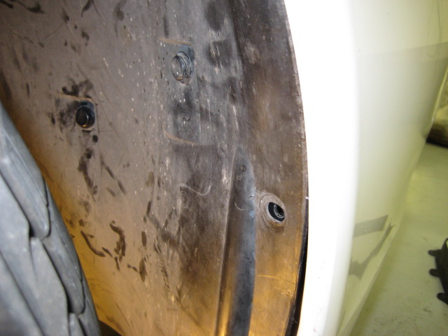

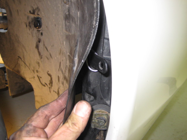

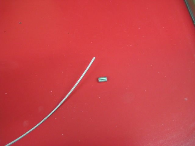

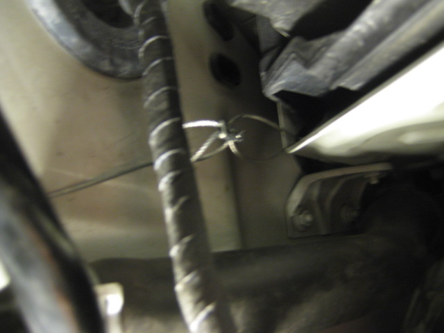

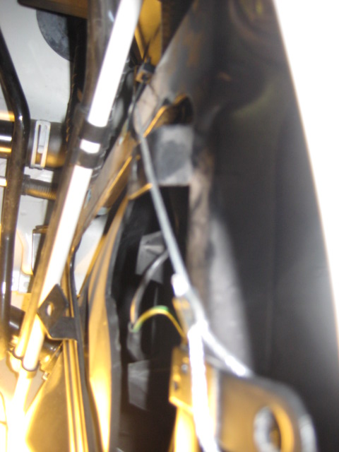

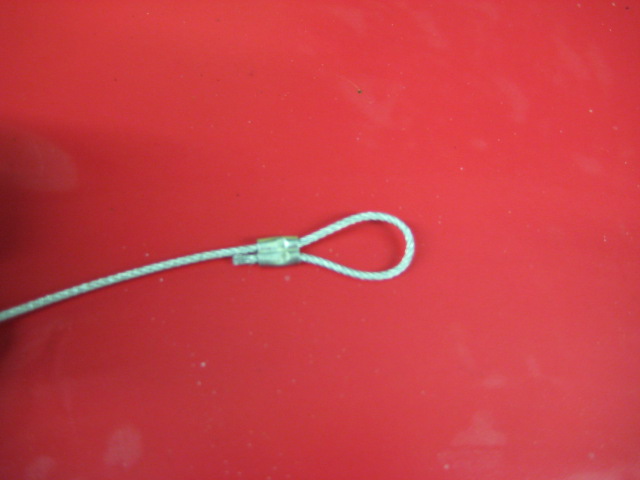

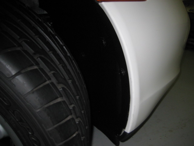

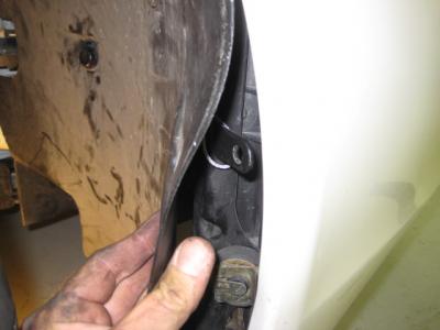

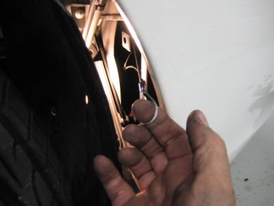

  4. As promised, I did a little re-engineering to make the problem of dead battery/locked front bonnet (trunk) access a little easier. Before proceeding to the fix, I’ll share a few things I learned during this rather frustrating event: 1. Never ever leave your key in the ignition for any length of time – it will drain the battery 2. The “red” pull-out tab in the fuse panel apparently is NOT a direct 12VCD link to the bonnet switch 3. Apparently ALL Boxsters have the manual bonnet release cable under the right (passenger side) front fender. Reading the various threads and the factory service manual can be confusing re MYs pre 2000 and post 2000. Mine is a 2002 and sure enough…the cable was there (thank goodness and the Porsche engineers). 4. The cigar lighter point is not sufficient to recharge an extremely depleted battery. Even if it were, I personally have my doubts that one could use it without a wiring meltdown…just my opinion, but my recommendation would be to avoid this route if at all possible if there is any question re the amount of amperage being transferred across this point. On to the fixes. This is the first of two issues I plan to make changes to. The second will come later because I have to gather up some parts. Here’s version 1 involving the manual pull cable. Porsche did a very sensible job of providing a (secure) manual backup. However, it’s so secure, it is a real ordeal to access. Therefore, my fix makes it easier to access while at the same time keeps things secure from the standpoint that most (Boxster-savvy) would-be criminals will likely assume the cable is factory OEM. All I did was extend the OEM cable and loop it over the outer-most fender liner tab. I used .06” stainless cable. The extended cable works the same. Now we only have to remove one fender liner retainer to reveal the cable loop. A simple pull and we’re in. I did make one change that is not shown in the pictures – the cable extension is actually routed BEHIND the horizontal cross member and held in place with a cable tie. Note that the pic of the two “loops” shows the cable running out of view to the left – this is to illustrate the two loops only.
  5. Apparently that was/is the case...I'M IN!! Loren, once again, you are the man!! Watch for my fix.
  6. Loren: So you are saying that the 02 WILL have a cable?
