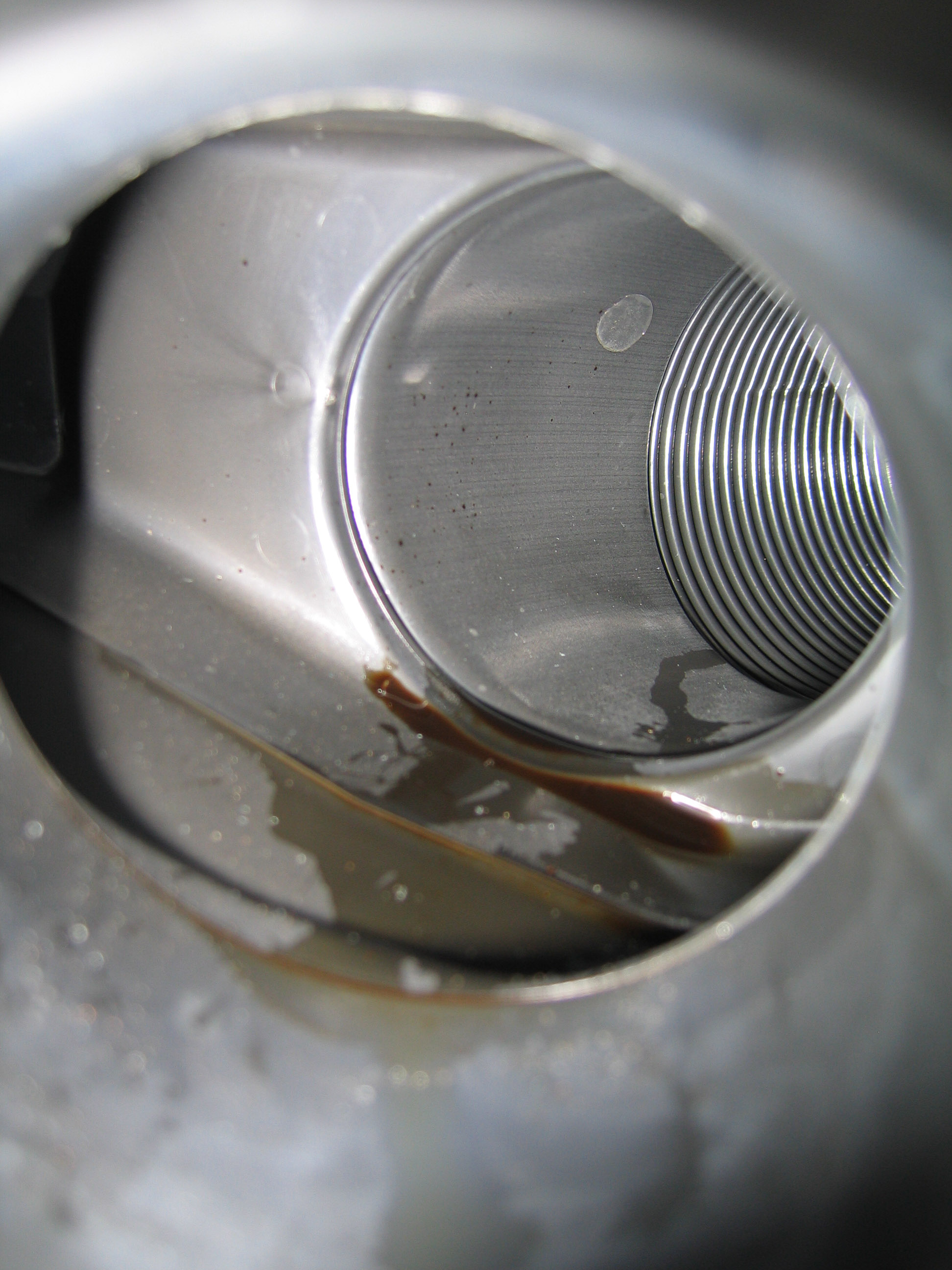

  1. I replaced the A/OS and the car seems to be working well again. No wandering RPMs at idle, no rough starting. The CEL is off, but it took a few days to come on the last time I unhooked the battery. I'm not out of the woods yet, but it looks good so far. A note to anyone replacing their Air Oil Seperator: DO NOT TRY TO REUSE THE COMPRESSION HOSE CLAMP. The clamp on the bottom of the A/OS is the spring/compression type and you need a pair of plyers to get it off. That's the easy part. In an act of tremendous and unforgivable hubris, I ignored the suggestions of others to put a new screw-type hose clamp on the new A/OS. After many cuts and bruises, a good deal of sweat, and a mild burn on my forehead from two hours under the exhaust manifold, I gave up. The compression clamp CAN NOT be put back on from underneath the car. Today, I bought a $1 screw-type clamp. I dissassembled the new A/OS (it was all installed but for the bottom clamp), replaced the spring clamp, reinstalled the A/OS, and had the car running in 35 minutes. Lesson: learned.
  2. I unplugged my MAF and got, in this particular case, the best result I could hope for: no change. The car still started a bit wonky, idled high, shuddered a little, etc. I'm going to buy a new A/OS tomorrow, locally if the price is reasonable (unlikely). Given that it may take a few days to get parts from CA to NC, and the fact that I am a very slow mechanic, it may be days before I have a good update for you. Thanks again for all of the advice. Even if the A/OS isn't the final solution, I can rule it out for $120 and some sweat, which is a lot less than any mechanic I know.

  4. 02 Boxster, manual, 50k mi Started this on another thread, but I have new info, a picture, and a question. Recap: - CEL on - Rough idle - Sometimes takes 3 tries to start - P1128 error code - Some oil in throttle body - Cleaned MAF, cleaned TB, air filter OK I think it's a failed Air Oil Seperator (A/OS), but this looks like a bear to change. Is there anything I can do to test the A/OS, or rule out other problems? Attached is a photo of the oil I found in the tube feeding air to the throttle body. Looks like about 1/2 a tablespoon of oil. The old 'unplug the MAF' trick won't help me because it takes days for the CEL to come on every time I unhook the battery, even though the starting and idling problems persist. What other tests can I do? Or can anyone say with 70%+ certainty that it's the A/OS?
