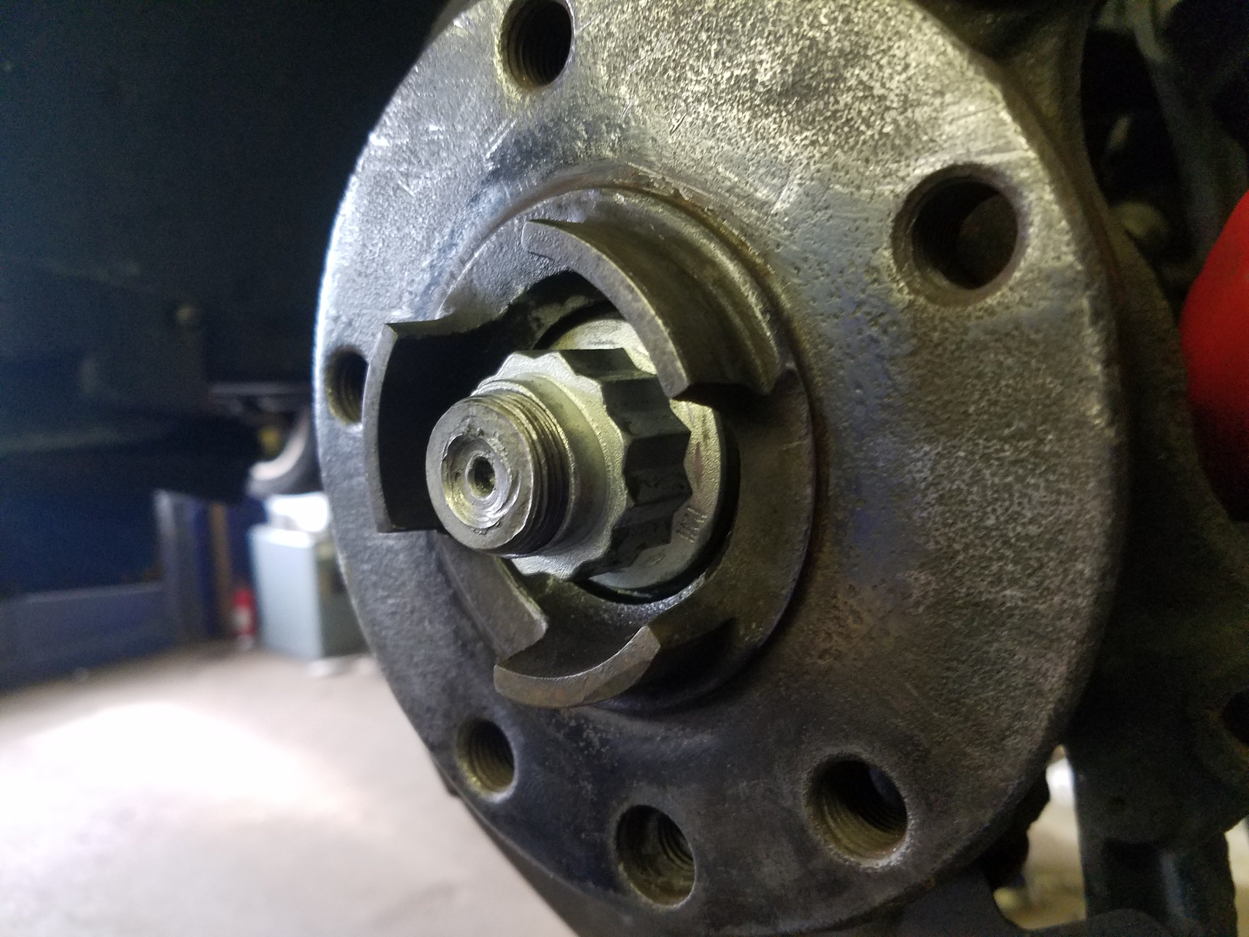

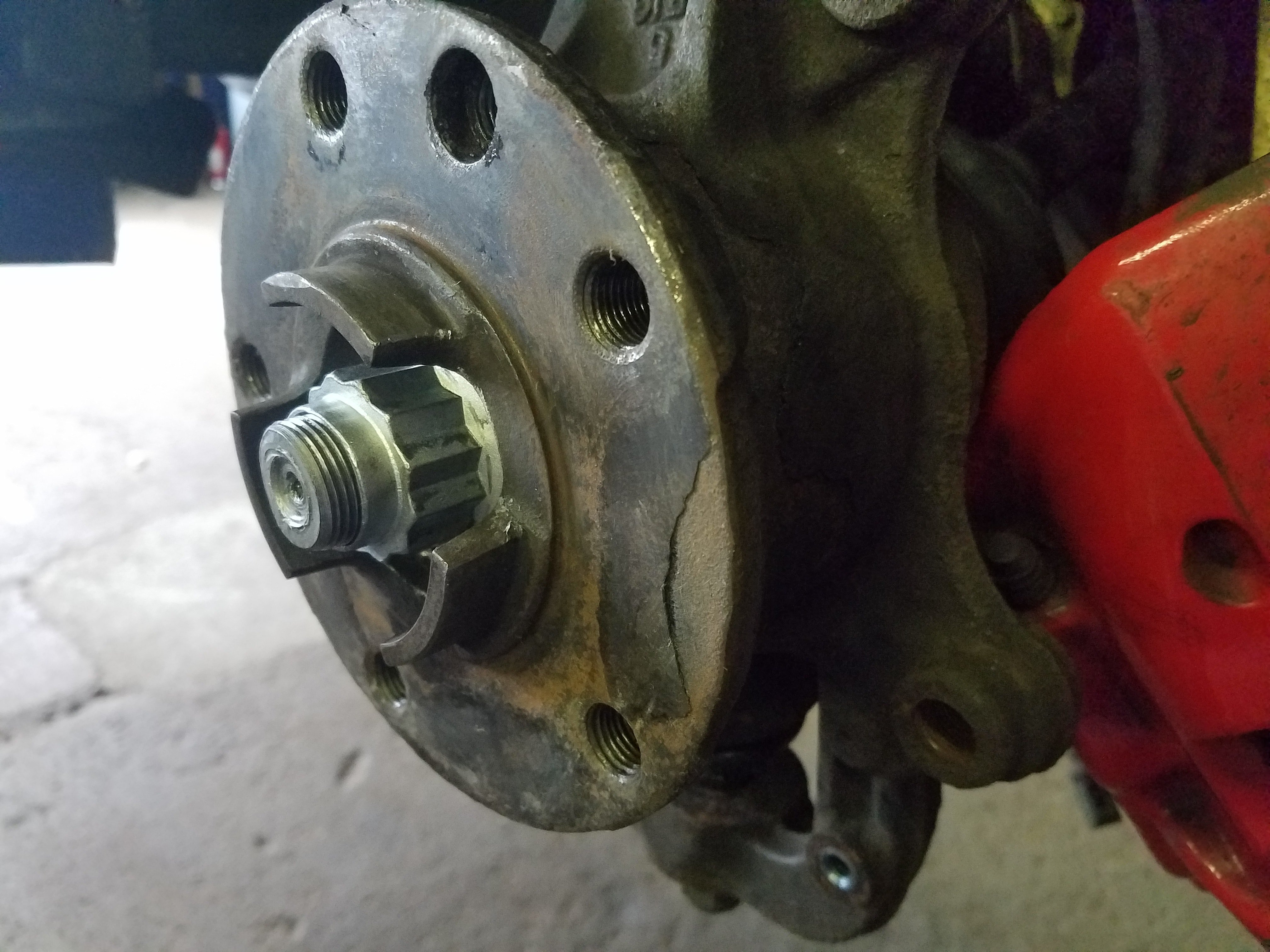

  2. Thank you. I have the car at Vertucci now and they are figuring it out. I'm Confused about a few things though. 1) If good rotors were installed on bad hubs, wouldn't they have pulsated immediately rather than working great for two months and slowly deteriorating? 2) Will the dial indicator used on the rotors give a true indication even if the hub is out of round or would the underling hub warping flow through to the rotor measurement using the spinning tool? Perhaps checking the thickness at various points with a gauge be more accurate in this case? 3) Aren't there some tension adjustments on the hub that can be adjusted? I'm just worried about spending another 4-5K and having the same thing happen again in a few months. Dan Jacobs is the recommended Porsche specialist in CT and they did not mention hubs as a problem. I don't trust the dealer either as they once told me I needed a new ignition switch because I put the wrong key in the car and it got stuck. I was able to remove my self with a paper clip. Below pictures of the hub in question after they were cleaned by Rabe
