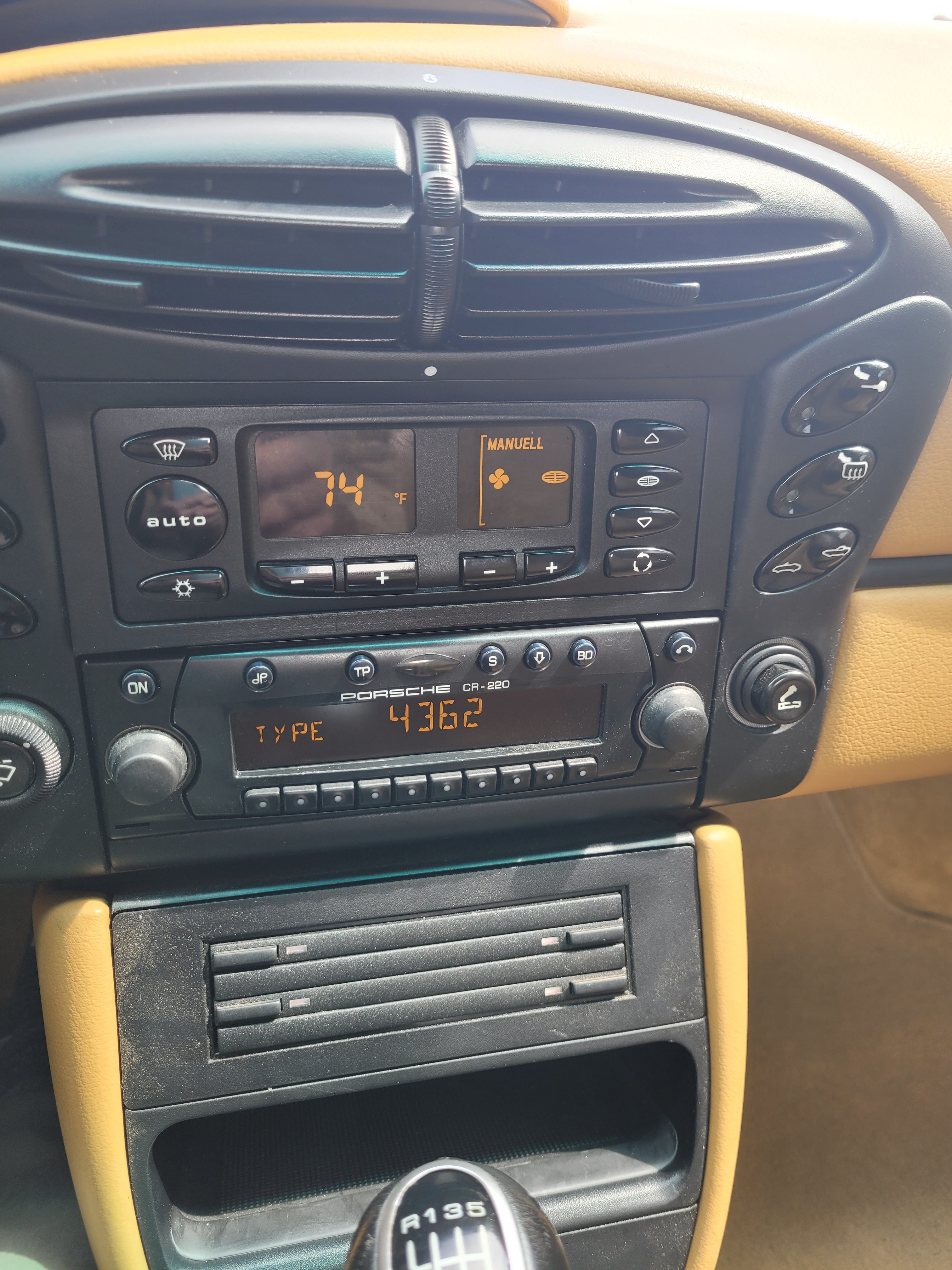

  1. 2002 Boxster S Radio CR-220 Pushed TP button for 10 seconds. Becker 1 came onto screen. Scrolled right: 47/98 Type 4362
