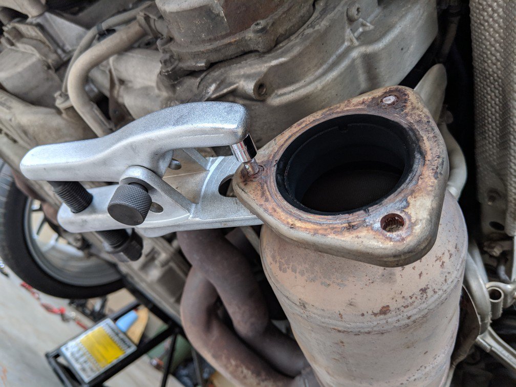

  3. Hi Pepi, the flange bolts on the header are NOT threaded in, they are press fit. Press them out with a press similar to the picture above. You can then replace them with M8x30 bolts. Mike

  7. I just completed a similar job. I used a ball joint separator to press the studs out. All 6 studs out in less than 10 minutes!
  8. I just completed a similar job. I used a ball joint separator to press the studs out. All 6 studs out in less than 10 minutes!
