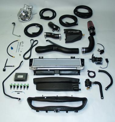

  7. Hey Guys...thought I would refresh this thread....no one else wants in on the Supercharger group buy for 2k off the price?

  14. Well guys, it may be time to bring up the discussion topic of supercharging our NA 996s again. Evolution Motorsports is offering a group buy promotion right now with discounts of up to $2000 per unit if 11+ units are sold (we can get together with some guys from 6speedonline to do a purchase). At around 8k, they become much more tempting to me personally. Evo has now sold 150+ units and claim to have, thus far, not had a single motor destruct. So, first, if anyone is interested, I will start a list of names and can coordinate a negotiated buy to give us the best possible pricing. Anyone interested can contact me at: bigbonebob69@yahoo.com Second, if anyone has any feedback from their evo supercharger install, or any tips or musings, please let us know. Also, if anyone has a cometing supercharger, please let us know why you went with another manufacturer. Thank you.
