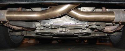

  1. I see you have the PSE mufflers...or are those the MKII muffler modification? I have a new set of the MKII mufflers to install on my 99. Would you say that the fender is easy enough to get off that it would facilitate a muffler install by taking off the fenders like you did? Is there a DIY for fender removal? I have never had the bumper or fenders off and don't know where all the nuts and bolts are. Those are MKII mufflers, I got them from a guy who had them modified and didn't like them and ended up doing something different. My car has Supersprint cat-bypass pipes as well. The car can be driven quitely around town if you drive smooth. When I get on it, it is loud. It has a real nice cup car sound at the track. I definitely gained HP. Next is the K&N intake.

  6. I just ordered a simulator from here: http://www.adaptiveperformance.com/ $11.00 for 2 including shipping. I'll let you all know how it goes.
