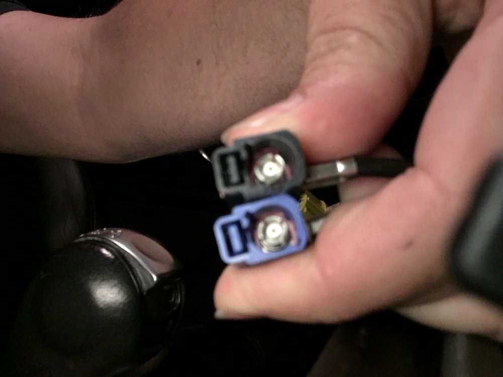

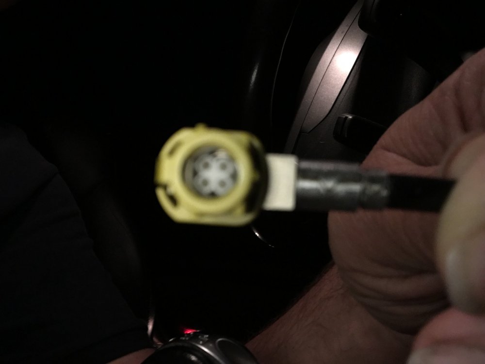

  2. I'm adding an aftermarket (Kenwood) radio to my 2009 997.2 Everything seems good, but the radio antenna is confusing me. I see three antenna connectors on the back of the PCM3.0. According to my wiring diagram the FM/AM and SDARS (Satellite) are in one connector (4-pin) and the other two are for GPS and Telephone. All the instructions I can find says there are only two antenna connections (Black and Yellow), but I believe these are all for 997.1. I can't find any reference to the 4-pin antenna connector online or any form of adaptor to connect to it. Anyone done an aftermarket install on a 2009 got any ideas?
