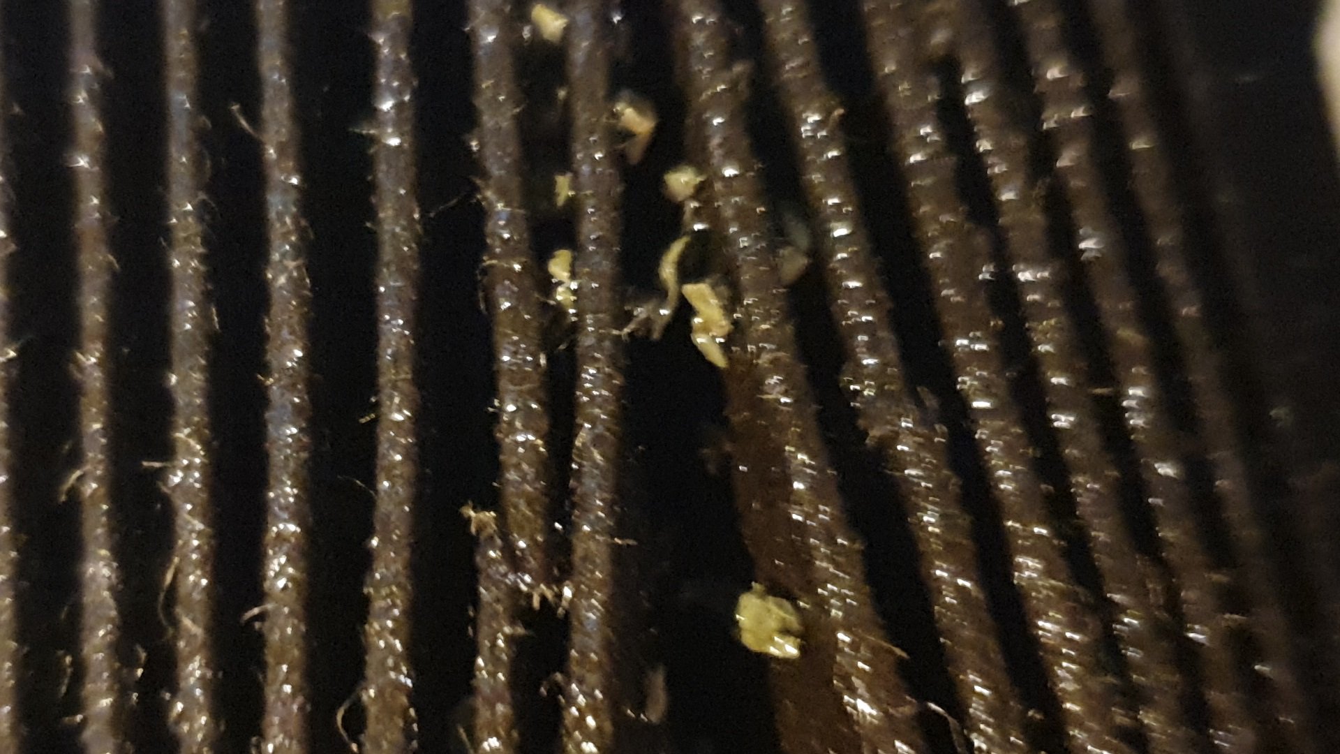

  6. Engine was warm enough I believe (Driven for 30min) I'll take another measurement later on. I would be interested in knowing the ballpark figure for a variocam chain pads replacement with the engine in. As you can see in the attached picture the oil filter looks pretty bad, I'm just not 100% sure it comes from the pads because the debris are relatively soft. The IMS bearing was replaced recently by the previous owner and based on the cam deviation values this engine should have been disqualified.

  8. Hi, During my last oil change I've noticed a large amount of soft brown plastic debris in my filter. I've replaced the chain tensionners which made my engine quiter during a cold start, unfortunately a slight rattle is still present until oil pressure builds up. According to durametric cam deviation is around -5 on one bank and almost -10 on the other. At this point it's almost certain that my variocam chain pads needs to be replaced. I live in Vancouver, Canada and I'm looking for a reputable shop which could address this issue asap as I'm not comfortable with driving my car anymore. Thank you for your help ! Michael
