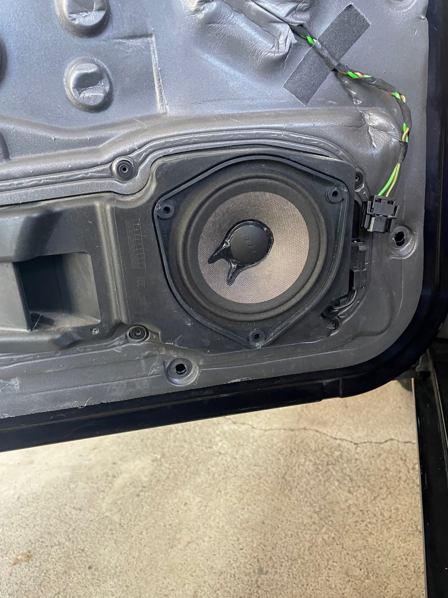

  10. Well since I didn't get any replies, I went ahead and just screwed them in place as shown. The door panels went back on without any interference. Bonus- I didn't break any door clips on either side. That's a first.
  11. I'm finally getting around to installing the new speakers and amp I purchased last fall. I just pulled off the first door panel, and from every thing I've previously read, it should be a direct install for 5 1/4" speakers. I found something completely different. Yes, I have the Bose system with the sub in the passenger side footwell. I can mount the 5 1/4" speaker as shown, but don't know if it would interfere with the door panel. Help me out please. Thanks, RJ

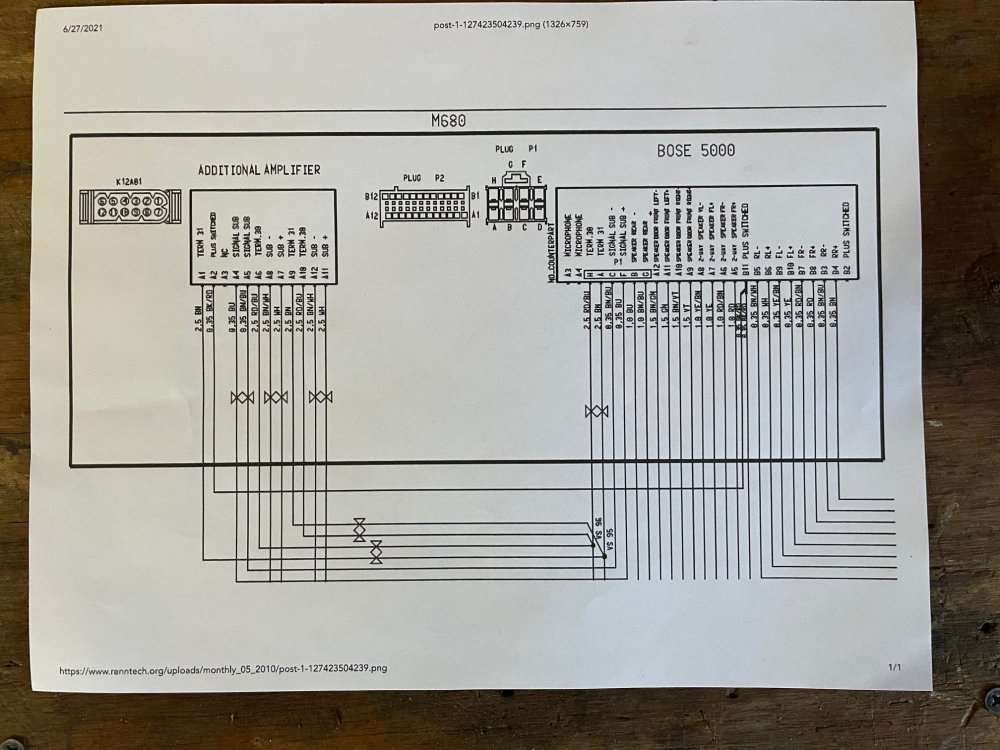

  12. I'm sure many of you have seen the attached schematic and have used it when upgrading your 996 stereo. Last year I installed an Alpine double din head unit with Apple car play. I wish I had done it sooner. So my next project this year (just got done doing a suspension refresh) is to install new speakers. Where I need some help is...in the schematic, what wires are coming from the head unit, and which ones are going out to the speakers? I'm planning on keeping the additional amp that powers the sub. I like the bass that the sub puts out. Not overwhelming. Thanks. RJ
