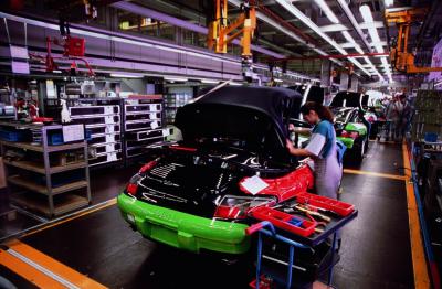

  7. I have something like that in my garage - already. I was thinking more like the green item - to protect the bumpers. SEE ATTACHED! Thanks! -LLD
  8. I was reloading and going through the "random factory pictures" and noticed that in many of them that semi-finished Porsche's had highly colorful rubber mats protecting the bumpers and sides. Having been through the nightmare of getting "tapped" in my last P-car - I was wondering if Porsche sells those mats for those interested in protecting the car in a garage or parking lot. Just a thought! -LLD "Larry"
