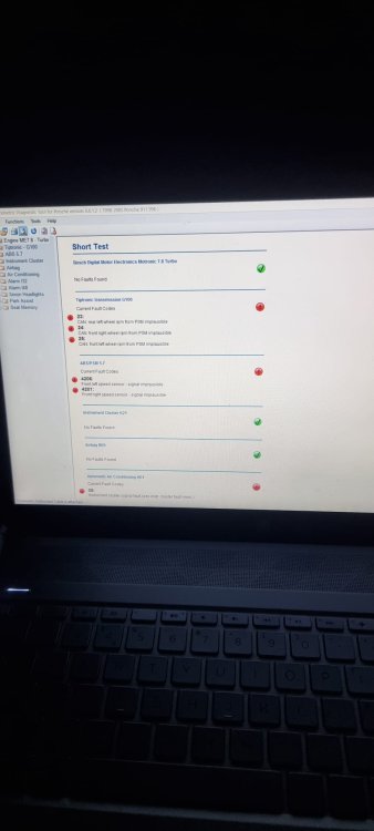

  2. Help Me Please?? 03 996 TT. Markski Tune, Hybrids, 5bar FPR. PS2s, 138k miles, UK car. I have the following errors come up on Durametrics. Tiptronic Transmission G100 23: CAN: rear left wheel RPM from PSM implausible 24: CAN: front right wheel RPM from PSM implausible 25: CAN: front left wheel RPM from PSM implausible ABS/PSM 5.7 4206: Front left speed sensor - signal implausible 4201: Front right speed sensor - signal implausible I have changed the front left ABS sensor (that was the first fault to come up in this saga). I have changed both front ABS looms (Spliced in ones). I have changed tyres so they all match, had alignment done and changed the brake switch. Steering angle sensor has also been calibrated. I'm now at a loss. Has anyone had similar to this and found a solution? Also, driving car normally throws no errors, but, if you boot it, PSM kicks in quite early and the brake pedal goes high (like its over vacuumed in the servo) and you can feel ABS working with slight clicks through the pedal after the slightest touch. Thanks in advance for any help given.
