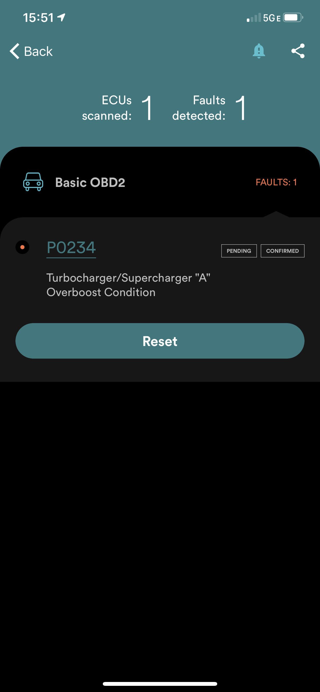

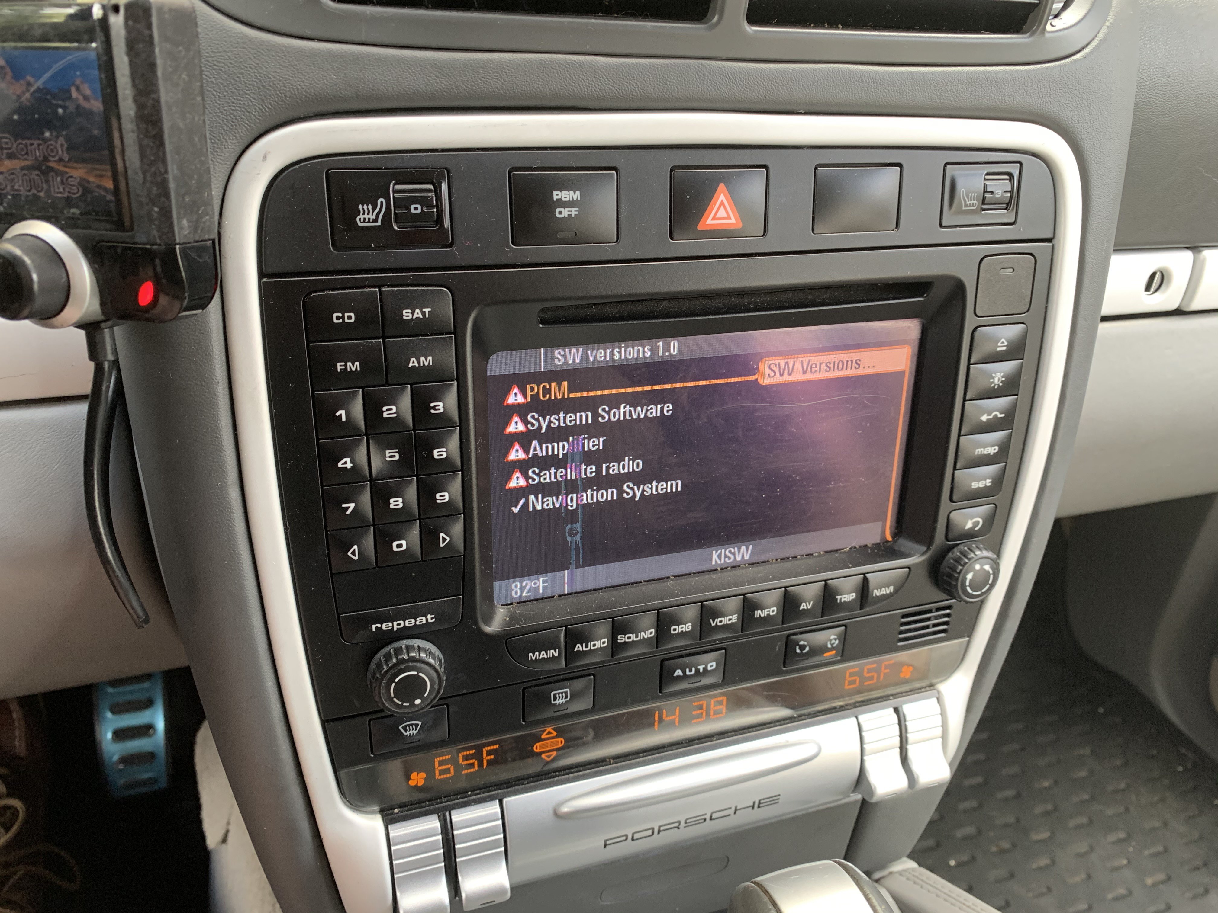

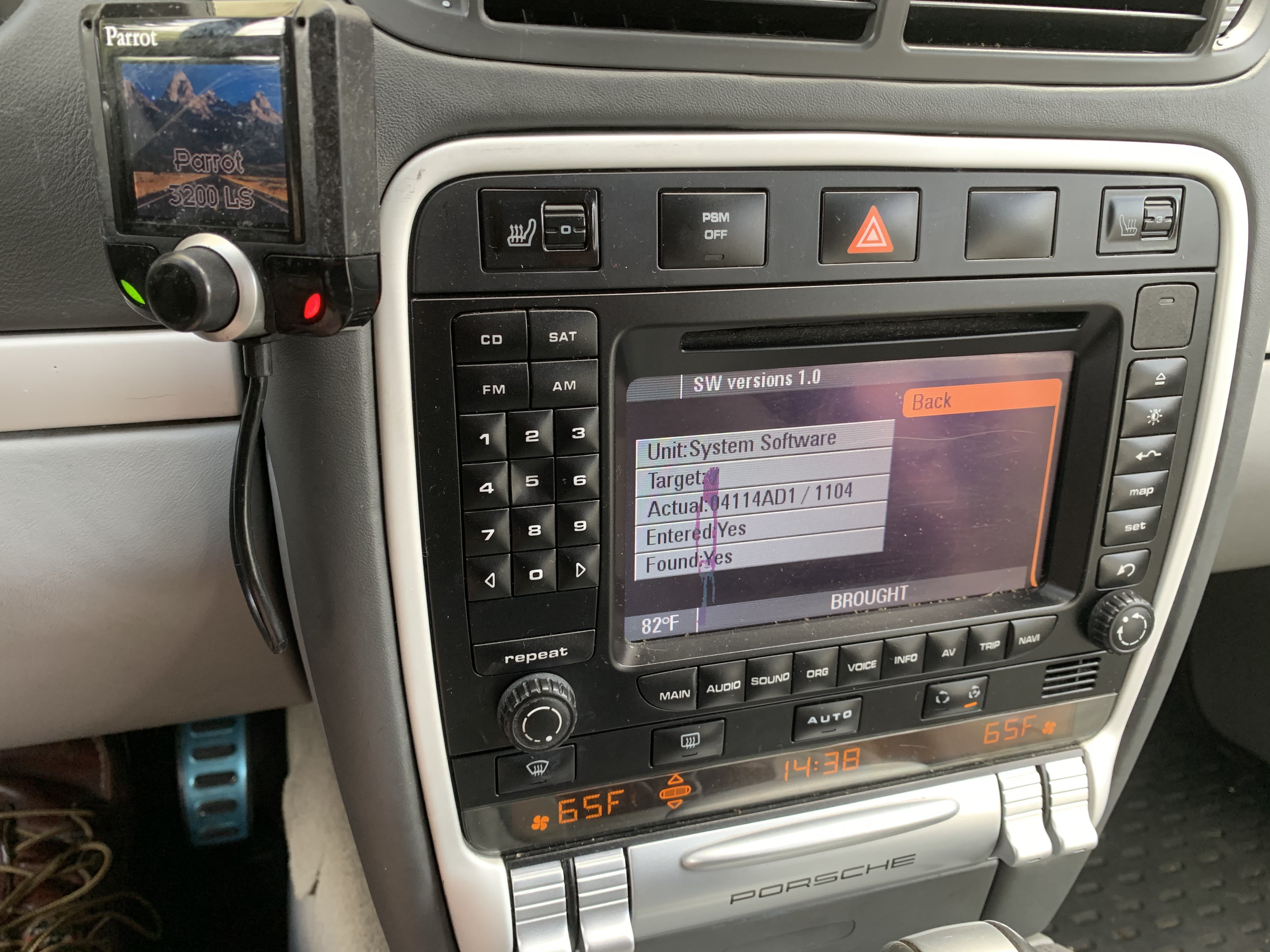

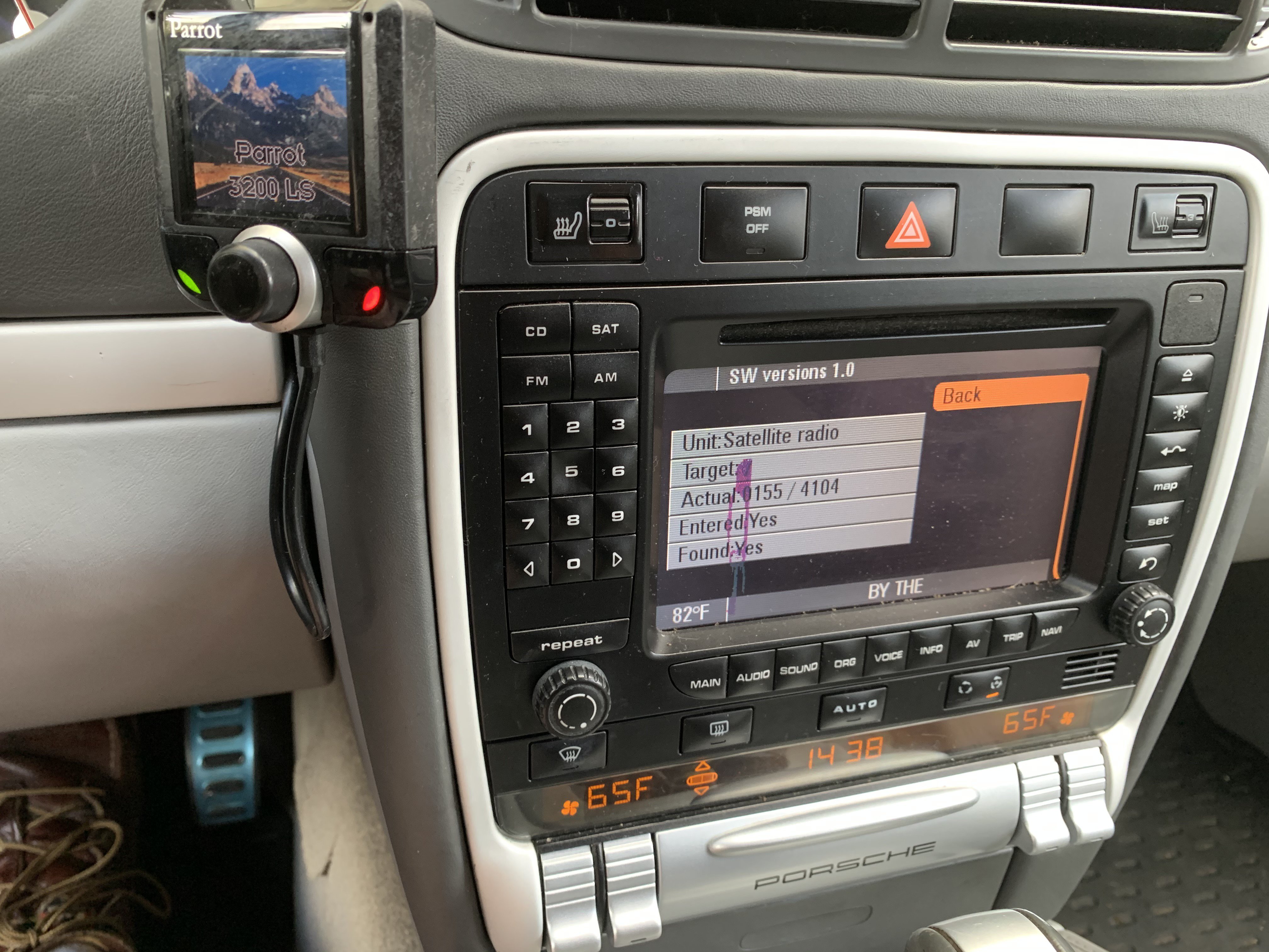

  14. Found a guy that did his own diverter valve replacement, I was already considering this "upgrade" as a PM. Are the lines running to the DV valves what I should be checking? Or should I be looking at sensors or the threeway valve that's on top?
