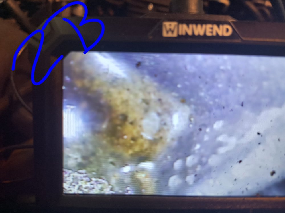

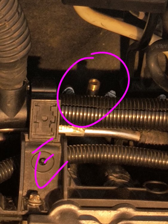

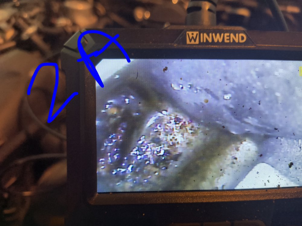

  2. So, I had a coolant leak in front of engine. Changed the intercooler, started filling and ugh coolant leak back center. Smoked it and the right hose had come off of the driver's side pipe! Here we go with the intake manifold.... Fixed that hose and smoked it no leaks, started adding coolant ( we all know it's not cheap) got it full and ....yep coolant leak dead center of engine. Here's were I need help... Area 2) looks to me like whoever changed the pipes didn't push them all the way on and the o-rings finally gave way?? 2A & B) are of the area under the 3 tubes, making me pretty confident this is my problem. But I put would be great! 1) I loosened the clamps on main coolant hoses in front and they were so tight it looks like they're still there!! Should I do something with this?? Well, I'm dumb and obviously switched to labeling in letters now instead of numbers! Ok C) This is the connection of big pipe underneath and I think it looks ok, opinions??plz.... D) I found a hole from someone not clipping it back into the y plenum so this is why fix. E & E1) the t between turbo vent and breather tubes was broken, just a big gap so I fixed that but I don't see anything that would go to the top of the t. Need help. Is it possible still on the intake manifold?? Plz help so I can put this thing back together!! And yes I've already changed the big coolant t and they changed the easy one to get to when they did the pipes
