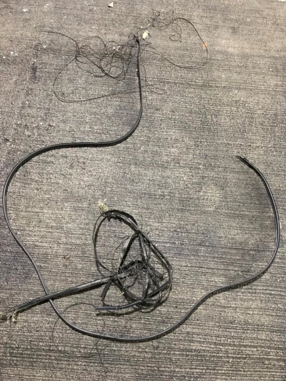

  1. Thanks to everyone's advice I figured out the issue and got everything working again. Turns out it was the serpentine belt, which was absolutely shredded (see picture attached). The process turned out to be very easy and did not take much time at all once I got the engine compartment open. I really appreciate all of the advice! Probably saved me about a grand in dealership fees or something ridiculous for the $35 and 2 hours of labor it too to fix.
