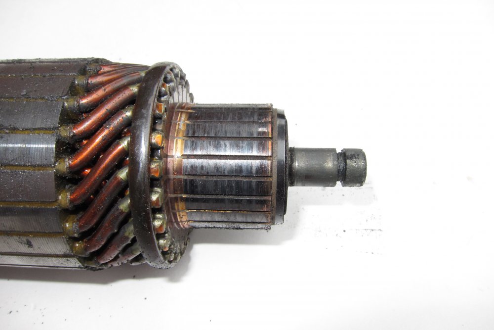

  5. This is exactly what my friend with a 2005 911 Carrera S 997 was experiencing. It would start easier when "cold" but had trouble starting after the engine had been warmed up; almost as if the battery was nearly dead. So he went out and bought the much talked about cable that members on Rennlist advised. Lots of talk, but very little testing. Yes, I realize when a cable at the crimped end turns "bluish", it is a sign of high resistance and heat, but that was not the case in my friend's 997. But he bought the cable, so I installed it. Easy, but what a job! So after installing it, I expected no difference and that was exactly what it was. I ran a load test on the battery and checked the alternator, no issues found. BUT this is what I found when I removed the starter and disassembled it. Just look at the commutators...first pic before, second pic after I cleaned up the starter armature and cleaned up the commutators. More info here: Porsche 997 Starter

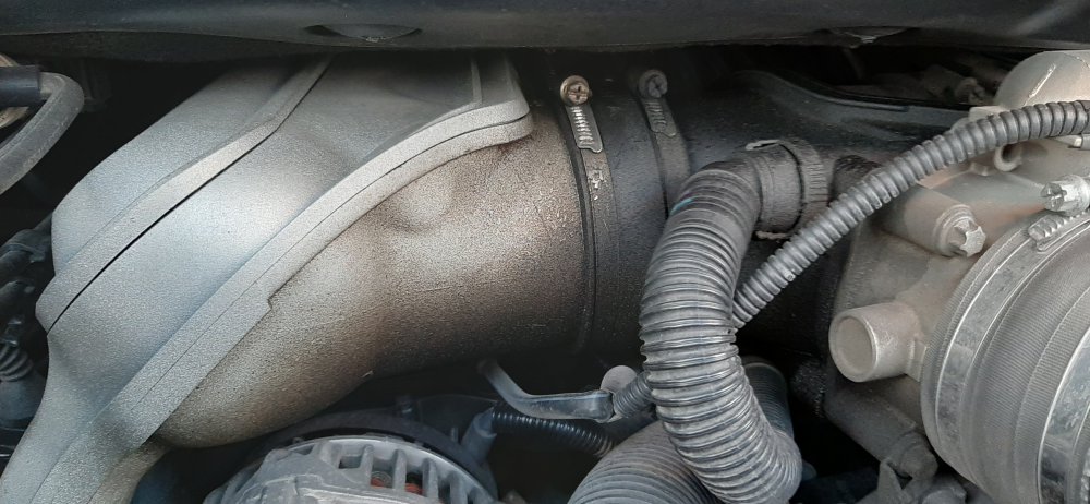

  6. I am doing the same. My manometer will be here by the weekend. All I need to do is make the connection to the oil filler cap. I was over at my friend's place yesterday and ran my code reader on it again after some codes popped up again. It looks like he has two less codes on the Readiness cycle since last week. All that is left stating "Not Ready" is the Evaporative System and Secondary Air Injection. I don't know his 997 or my own 991.1 GTS like I know my 993 (like the back of my hand). I had a quick look in his engine compartment and this is what I noticed. Nice that you can see an engine, unlike my 991.1. Notice the damp oil residue at the intake plenum and throttle. Time to take it apart, check seals and the AOS.
