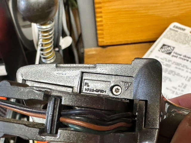

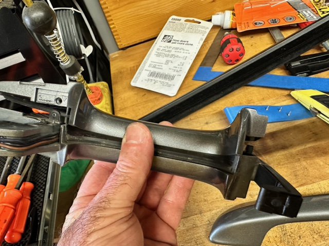

  7. Ok, so I removed the door handle and while I don't think they intended for people to take the door handle apart I did. It turns out that they embed the wires and the door switch/button in silicone. I was going to dig it out and get a closer look at the button but then I realized that the rubber boot that goes over the button has a rip. I'm pretty sure moisture got in there and ruined the switch, so I'll purchase another door handle. Here are some pic s.. .
