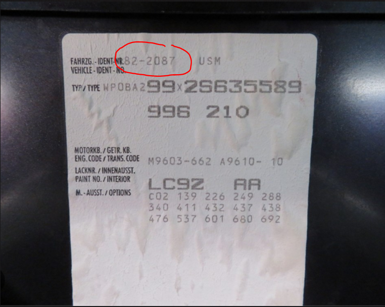

  14. 82-2087 number on the 996/986 hood label is it a dealership code or the car's Production Number?

  16. Yes. MB 722. Interesting as you saying they put bigger batteries only to some cars with tiptronic as this someone else's label showing A9610 but no bigger battery. Q: 82-2087 number on this hood label is it a dealership code or the car's Production Number?

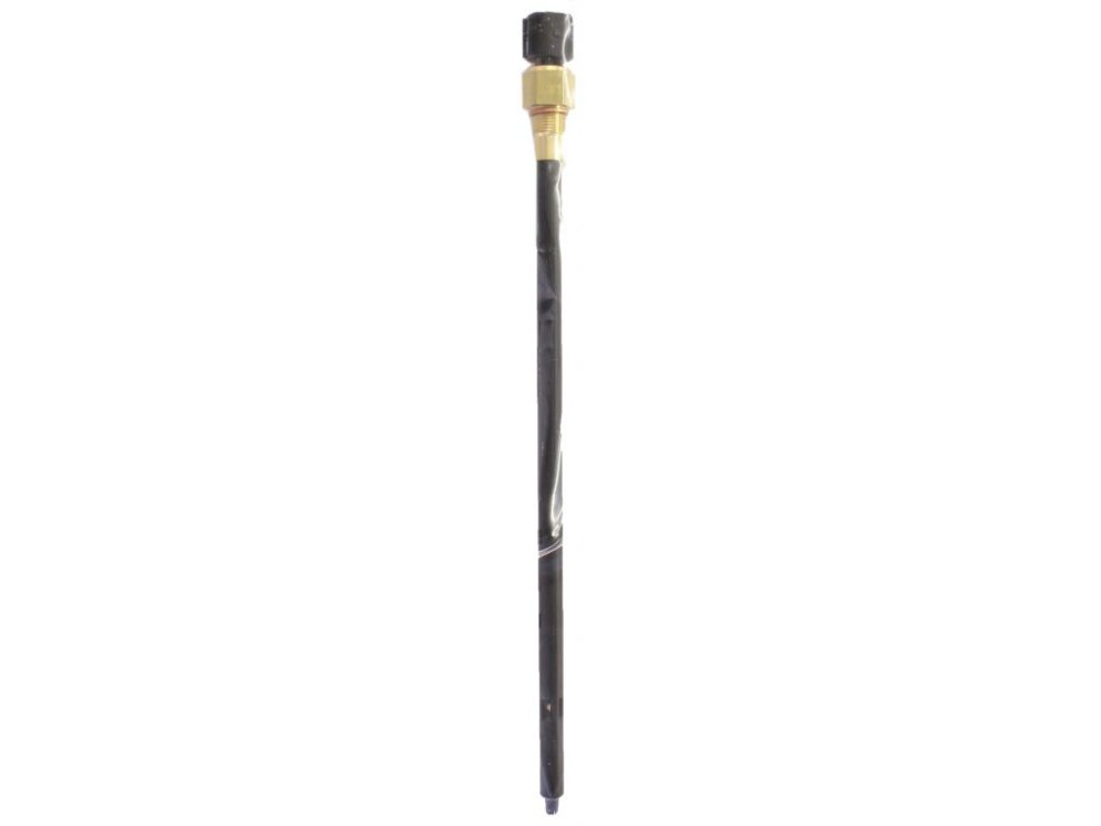

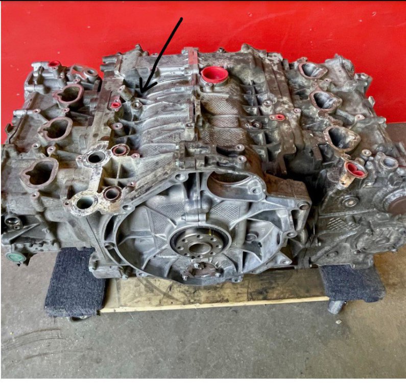

  19. There is a thread in this forum on the oil level/temperature sensor 996 606 150 02 location (called in PET as an "Oil Level Sender", which supersedes 996 606 150 00 and a guy said it takes him a 1.5hrs to get to the sensor by removing the RH intake manifold. Can someone who did it provide the steps (I want to avoid of breaking anything). 996 606 150 02 Oil Level Sender: The Blue arrow: The black arrow (the engine blok is pictured from the other way around, from the front of the car):
