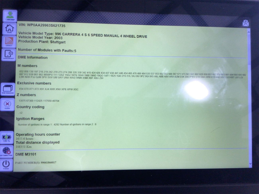

  2. Hello! I'm looking at purchasing a 2003 996 C4s and heard that another buyer was concerned about the average speed but don't know what to expect here. Is ~40mph unusual? Any insight is appreciated! Is anything seriously wrong? Any potential negotiation points? Here is a link to the listing: 2003 Porsche 911 C4S - Meridian Silver/Cinnamon - 67k miles - IMS/RMS/Clutch done - Rennlist - Porsche Discussion Forums RENNLIST.COM The Rennlist Marketplace - 2003 Porsche 911 C4S - Meridian Silver/Cinnamon - 67k miles - IMS/RMS/Clutch done - SALE PENDING, DEPOSIT RECEIVED Selling my Porsche, as I have just purchased another vehicle and no longer have the space/time/money for it. I... Thanks in advance! Max
  3. Hi Loren, Thanks for the ranges! Do you think the Range 4 is cause for concern in this case? Best, Max
