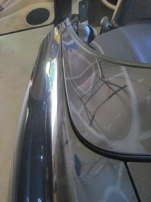

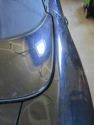

  9. All: I've noticed that the clamshell does not close properly on my '03 Boxster - more a problem with the top down than with the top up. It appears to be shifted a bit to the left, as you can see in the attached photos. I would say, from looking at the gap in the bodywork and how the alignment pins line up with the sockets they drop into that there is on the order of 1/4" of a shift here. Top Down: Top Up: Is there any way to adjust this out? I don't see anything obvious, and the vertical adjustment (left side vs right side compared to the rear deck) looks good. I have recently had to mess w/ the clamshell, as I had an AOS replacement to do and it was a bit of a struggle, so it would not be out of the realm of reality that I tweaked something while I was doing that. Any ideas? TIA...
