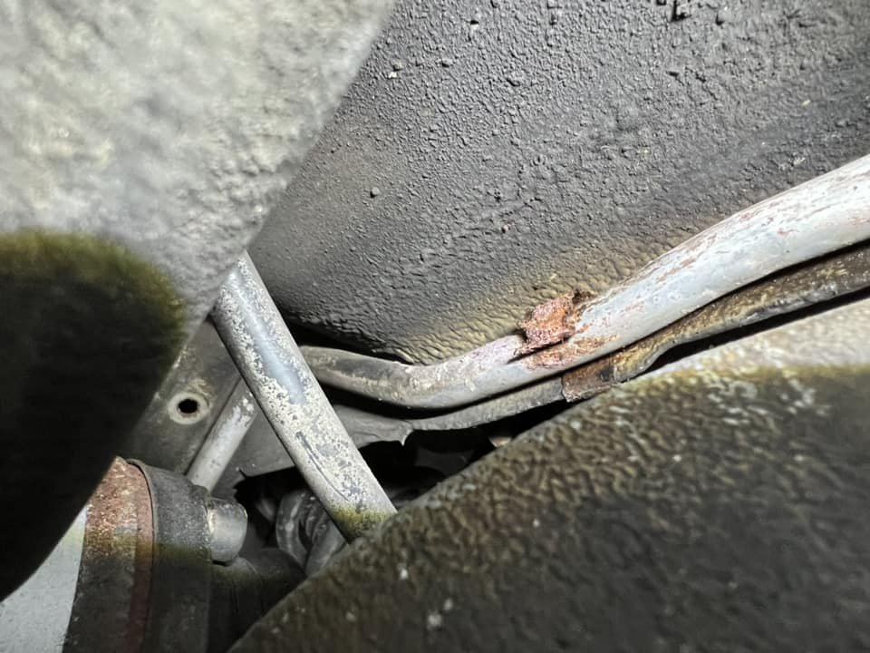

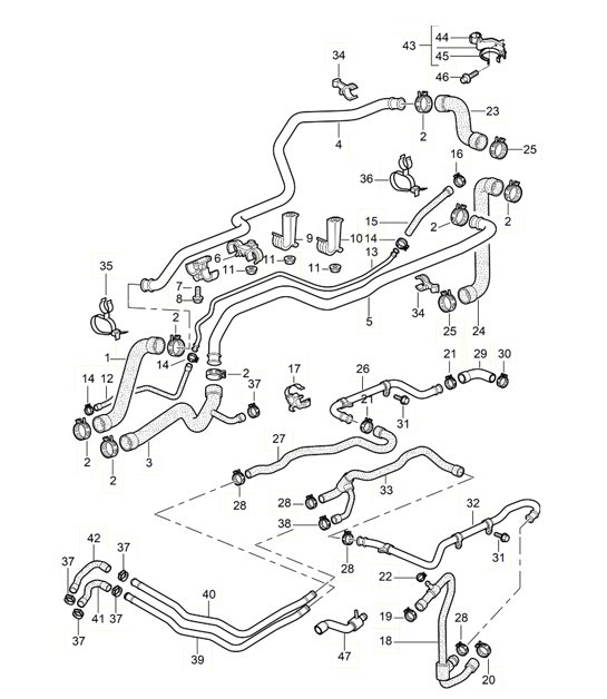

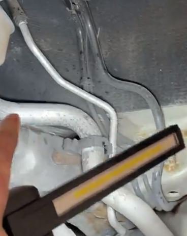

  7. Hi 🙂 Has anyone ever changed the aluminium pipe that comes to the top behind the expansion tank ? I have a little hole I think 😞 If so, is this doable without having to remove the engine ? By just disassemble some parts on the top of the engine ? And, what is the utility of this aluminium pipe ? Thank for all your support Mike My car : 996 C4S 2003 Triptronic This pipe and the clip who eat it 😞 I think it's the number 13 : See on a video, it's this one :
