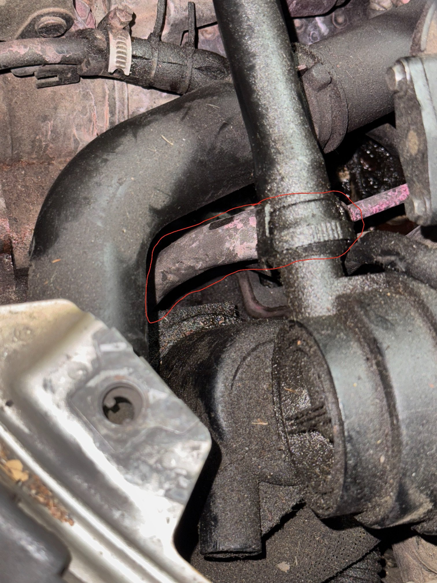

  1. I have since worked out that the metal pipe (to the right of the rubber hose in the first photo, also covered in pink coolant residue) this rubber hose connects to is called a "breather hose" for either cooling the engine and that it may (or may not) be only for Boxsters with an automatic transmission. The part number for the metal pipe is 99610621002. Except whenever I search 99610621002, it always comes up in parts diagrams on its own. It never shows which coolant hose then connects onto it. It's the coolant hose that connects to 99610621002that I am interested in.... Can someone knowledgeable please help. Cheers.
  2. Hi everyone. I have a coolant hose leak. But I don't know what this one is called or what the part number is. Can somebody point me at the right direction please? You can see it's the hose covered in pink coolant in the photos. It connects to a small metal coolant tube? on one end, and seems to run towards the rear firewall on the other end. It is located right next to the AOS and runs underneath and perpendicular to the AOS breather hose. 1. What/what part number is it? 2. Is it easy to replace DIY?
  3. I have since worked out that this part is the crankcase cover and that there is a gasket behind it. It looks like it should be quite straight forward a job to DIY.... It might just be that I need a new gasket and that's it... When I take off the cover, will there be coolant or oil leaking out everywhere? Or is this part of the engine too high up to have oil or coolant when not running? Is it actually coolant or oil inside this thing? The large bore rubber hose would suggest coolant... you wouldn't run oil that way, would you? I actually do have an coolant leak also... something like 500ml per trip - which is why I opened the access hatch in the first place, suspecting the coolant pump... but judging by the wet sludge, maybe it's leaking from the crankcase cover? What adds to the confusion is the parts website referring to the crankcase lid as "crankcase water duct".. which implies coolant inside? But a quick google on "crankcase water" reveals it being a bad bad thing of a blown head-gasket/oil water mixture.... https://www.design911.com/p/porsche-996-crankcase-water-duct-99610102102-99610102103/ Does anyone have any tips and experiences on doing this job? Thanks in advance.

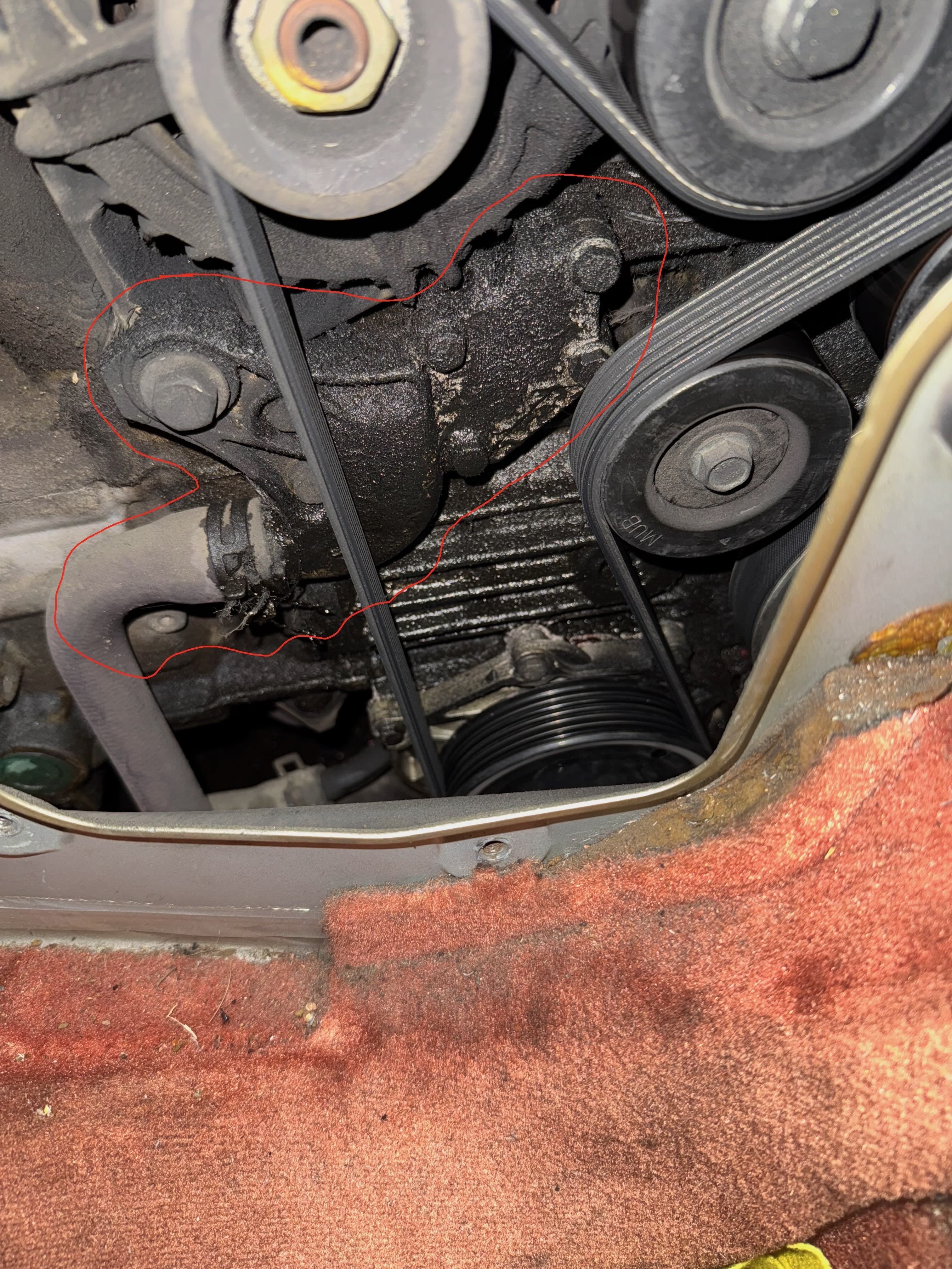

  4. Hi there. I am a long term owner. I have had my MY97 Tip for 21 years now and counting. Done around 300,000km. It's one of my two daily drivers. The car has been very reliable but I have noticed a constant oil leak for years - something like 0.5L loss every year maybe, so nothing drastic. But the leak is very real as I have a constantly wet oil puddle on the floor at the same spot. Anyway, I finally got around to opening the access hatch and I think I can see where it might be leaking. See photo. This is the only part of the engine that's oily wet. It seems to make sense to deduce that given the alternator is dry, and that oil runs downwards, it's this part here, circuled in red, that's leaking from the seals (assuming there is a seal in there behind those bolts). My question is: what is this part of the engine? Is it oil running inside that clamped hose? Is this likely a seal problem or should I simply tighten the bolts? That big bolt on the top left is very distinctly different from the rest. What does that one do?
