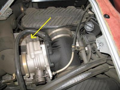

  11. The black rubber boot...center of pic.....check valve on one side.....does a vacuum line hook to the other hole on the driver's side....PLEASE INGORE THE YELLOW ARROW AND DON'T POST ASKING IF I'M TAKING ABOUT THE PART THAT THE YELLOW ARROW IS POINTING TO...I AM NOT TALKING ABOUT THAT PART, THAT WILL BE THE THROTTLE BODY...I can't believe how hard it is to get an answer here to a simple question

  14. Since I can't get a straight answer on the prior post, I will go this route...I'm putting in new vacuum lines in my 1998 Boxster, Looking at the car from the back end, I know that the black side of the valve goes in the right side of the rubber sleeve or plumens as you might call it and the white side goes to the Y connector. Is there a line the goes into the left side and if it does, where does the other end hook to. Thanks

  17. a yellow arrow pointing to it... as I was tring to pull this off, it seem to make the butterfly move, now with the MAF unplugged, the car wants to shut off at idle. It has to something simple Can you be more specific as to the parts that you are describing. Maybe the PET (page 67 in particular) can be of help here. http://login.dealerskins.com/SiteSpecific/...USA_KATALOG.PDF JP
