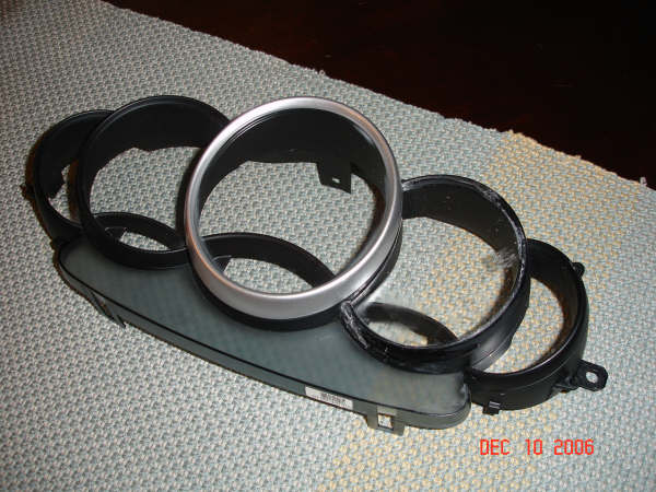

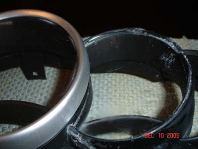

  1. BJCarrera, It is possible to polish plastic, but it takes a lot of patience and, to be honest, I'm not sure that you would want to try to polish out something that you are looking through because the fine scratches will probably always be there. I know that several companies make kits to polish out the plastic headlight assembly covers. One place ( http://www.properautocare.com/blbapllepoki.html ) carries a full kit to remove yellowing and polish out scratches from the lenses. I used this kit with a corded drill to polish out the inside and outside of the headlight assemblies on my SC400 when I retrofitted the Porsche Bi-xenon projector assemblies. It took a couple of days and some good blisters from the wet sanding phase, but I couldn't be happier with the results. This kit may help you with this problem. I can email some photos if you want to see what I'm talking about. I don't know what the other forum member's experiences have been with them in the past, though. Specialist Thank you- I really appreciate the help. I hate to buy a whole cluster if all I need is the overlay.

  5. Unfortunately I think you are out of luck...you'll have to buy the cluster (perhaps you can get one used?). Also there is no way to get that glue off. Most folks use a removable silicone adhesive. I used UHU Tac. Shoot . . . I thought someone would say that. One other question and sorry if this is an obvious one. I assume my cars computer retains all the mileage, ECT... and if I plug in a new or users instrument cluster the instrument cluster will just bring up my cars mileage?
  6. I need help. I attempted to install aluminum rings on my cluster gauge. I was using the supplied super glue and got glue on the plastic lenses. I tried to remove the super glue from the lens and made things worst, now the lens is scratched and has glue on it. Is there anyway I can purchase the instrument cluster cover without having to buy the whole instrument gauge cluster? If so, does anyone have a part number? Or, does anyone know how I can get the glue and scratched off the plastic lens? :cursing:
