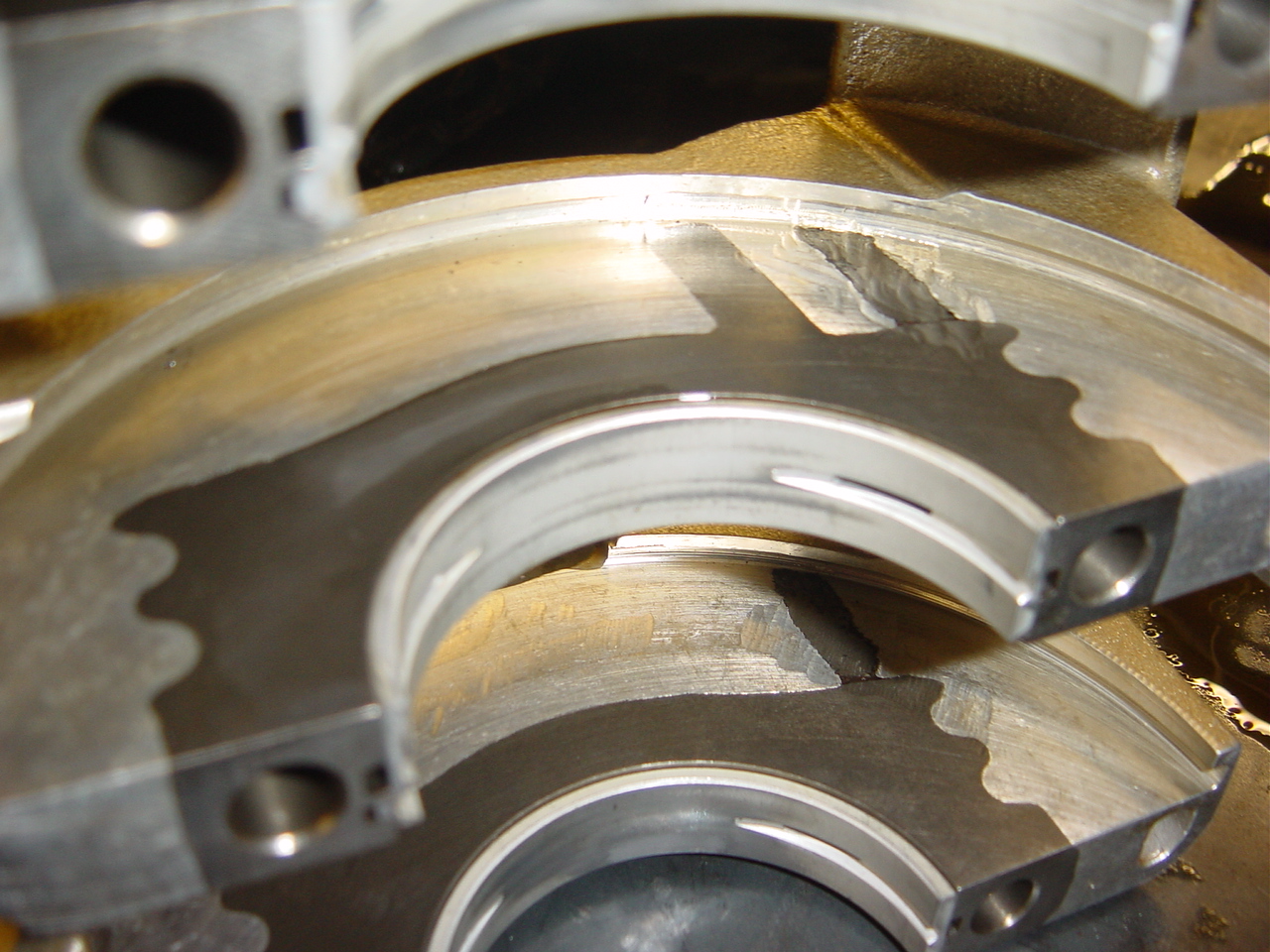

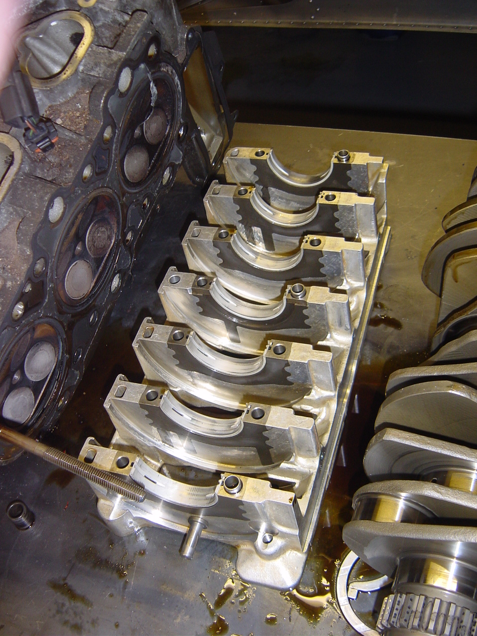

I made another very useful contact yesterday and took the faulty crank cradle to show him. He noticed that the metal was flaking off one part and I've attached two photos to show this. I'm now more convinced that the metal that was found in the sump was off this particular part. Whether it was the cause of the misfire we'll never know but I doubt it was. He also said that the grind marks in my earlier posts would definitely have been done at the factory. It looks like they were trying to grind off some material from the casting process. Also you will see from the other attached photo that another part of the cradle is showing fractures in the surface metal which I'm sure in time would have gotten more severe and flaked off as well. My thoughts are now that it's probably a good thing that the engine was dismantled to discover this. If it the msifire had been identified and cured without engine dismantling, more metal could have broken off and caused a major engine failure whilst I was on the motorway or other fast road. Given the evidence I've accrued, I'll write/e-mail to the Director of Engineering or equivalent in Stuttgart and see what response I can get from the Quality Control angle. Best regards John

Lee, We may have some common ground in the engine rebuild/replacement question and what Porsche's actions may be, if you've seen my topic Misfire 2003 996 C4S 118,000 miles. http://www.renntech.org/forums/index.php?showtopic=11615 What started out as a misfire moving from one bank of cylinders to the other which couldn't be diagnosed with certainty, has now progressed to a full engine dismantle and tomorrow I'm taking the parts in the photos in the topic to the OPC where I bought the car from to progress matters. As was stated in the replies to your topic, I think it's important to have a good degree of photographic evidence to encourage and secure all reasonable assistance whilst seeking a problem identification and resolution. Good luck with your situation. Best regards John -

Thanks for your response. The grinding/fettling of casting seams was favoured by the specialist as well. However my thoughts are that they are too random to be factory-based marks as I would have expected anything done at the factory to be far neater. The OPC that I purchased the car from commented that they had experienced swarf being trapped in tappets causing a misfire to move between different cylinder banks, but that was on a new car. They'd not seen swarf in a car with the high mileage that mine has done. Rgds John
Hi Eben, Many thanks for your comments. When I saw the engine last week I noted there were some other gouges/grind marks on another part of the engine. I went back again today and took some more photos for comment. The photos are the same part and photographed at both the left and right ends i.e. there is gouging/grinding at both ends. We're not sure whether these are manufacturing marks or anything problem-related. I did notice that on one photo there is evidence of the metal cracking/flaking. In relation to your question, I can't say which of the two crank block halves are upper and lower (or right and left) but I'm wondering if the one half that shows the gouges & cracks fits into the other part shown in the latest photos and that there is a relationship between these marks. There are no broken spring valves or anything else that the specialist has seen as broken when dismantling the engine so we can't relate anything back to the metal that was found in the sump yet. Hopefully the relevant people at Porsche Cars GB will respond soon and I can advise you of further progress. Best regards John
Hi Loren, Thankyou for your input. My concern isn't with the semi-circular bearing inserts but I'm focusing on the darker colour metal. Attached is a photo showing the difference in the profiles of the dark metal sections in one half of the crank block where the damage has occurred (the other half looks fine) i.e. some have no elongations into the alloy sections, some have one and some have 3. This is quite different to the other half of the block (see previous photos). Is this normal and do you know where there might be other photos to compare with? I hope that we can get a reasonbly quick response from PCGB after the holidays and get some expertise on the situation. Happy New Year to all and thanks to everyone for viewing and commenting on the topic. Best regards John
Looks like we're into very a interesting topic and I like your suggestion. I did note that the the profile of the insert on the other side of the indvidual section was not the same as the side showing either one "handle" or two "handles" i.e. the other side was similar to the other half of the crank block which had no "handles" at all. Therefore these "handles" do not span the thickness of the sections. (Hope I've explained myself adequately, photos can say so much more!!!). If the inserts are there to provide strength and higher performance characteristics (as I understand the earlier all-alloy crank blocks were problematical), wouldn't they be forged rather than cast? I tried various web searches for other crank block pictures but didn't come up with anything positive yet. After searching different links and discovering different part names, I question whether the right term for the parts in the photos is crank block, crankcase or crank cradle. Any thoughts? Rgds John
The specialist cut open the oil filter after he had found a small flake of metal (possibly bearing metal i.e "white metal" or Bebbitt metal) in the sump. Nothing else was found in the filter. Also did you notice that the profiles of the inserts differed between the two halves in the thumbnail photos? I can't see why there should be "handles" in one half and not in the other. Rgds John
Hi again, Glad the better photo gave you more info to assess. Any thoughts on what appear to be cracks in the darker sections? The indie hasn't mentioned finding any broken springs which was one of the early potential suggestions. Thanks for your comments on the car as well. With regard to the car itself it's my first Porsche, I was driving a M3 at the time I saw it. I had taken some time out for lunch (which is unusual for me as I often use the time to travel between clients, catching up on e-mails etc.) and chose to look around that OPC. My first words to the salesman were "I'll be honest with you I'm not buying but is it OK just to browse?" Just shows how wrong you can be!!! The combination of the Cobalt Blue paintwork, the red calipers and the alloys had me hooked. More importantly my wife loved it too (she hated the M3 for some reason). It was their ex-demonstrator and as I sold the M3 myself I got a £500 off their asking price. I'll do some more web searching to see if I can find some more info on the inserts in the crank block and try and post some links if I find anything useful. Rgds John
