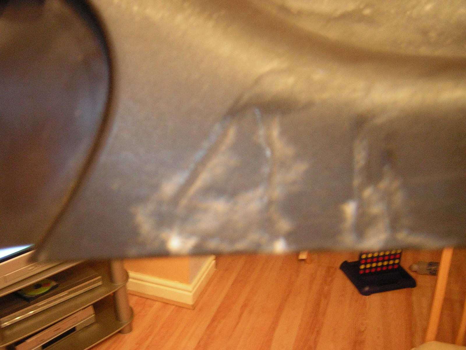

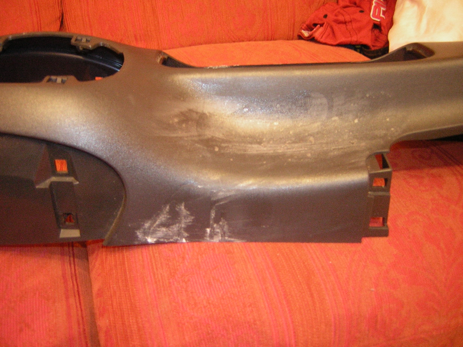

Yes screws under the rubber mate. under the ash tray, under the shift boot and also one more screw... pull up on the coin holder and once removed, you will see a screw under that. Thanks guys, I found them all and fitted the new one today, only took 30 minutes, pics below, no more glue for me.
Dear All, Seasons greetings to all, I've spent the last couple of days tidying up those annoying little things, such as replaced the sun visor hinges, replaced a snapped off wind deflector bracket, steam cleaned and shampood carpets etc etc. Any way to the point the very last job I had to do was that I had a small tear in the leather part of my Tequipment handbrake, being fussy I decided that a bit of superglue and then a rub over with shoe polish would cure it. The fatal mistake was I took the superglue pot into the car and rested it on the console, I'm sure you all know what is coming next - YES I did knock it over and spilled superglue all over the console. I have managed to source a second-hand item, and have worked out how to remove the old one, However the 2 items I need to swap from the old to the new are the storage lid and the lock, does anyone have any tips or a link to a procedure for doing this. Many thanks Nik
