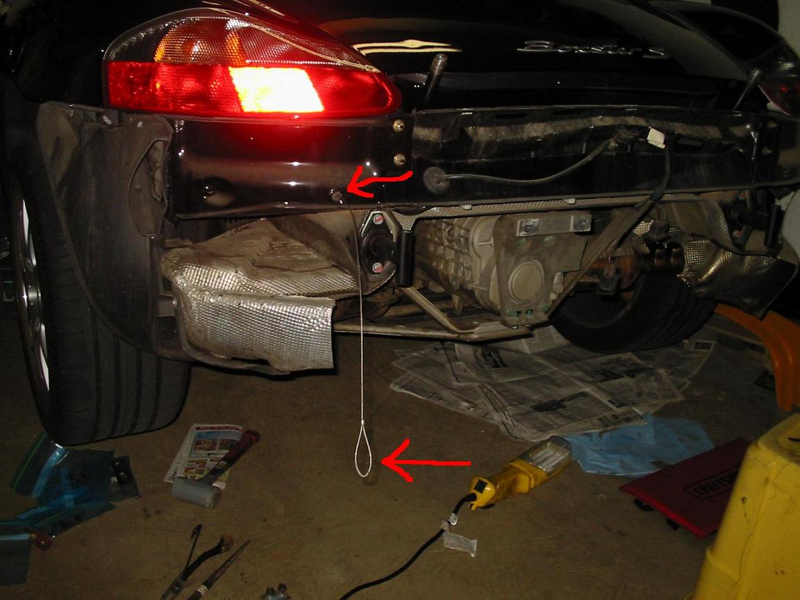

  12. ok, I definitely recommend removing the rear bumper if you want to remove your muffler to make your life much easier. Also, what the hell is the wire on the pics for???? is that to hang myself if I forget how to put everything back??? :thumbup:
