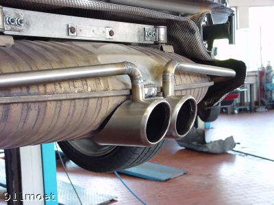

  6. The tubes used are Stainless Steel T304, 1" (OD) 16 gage. I used my original exhaust and replaced the tip. (see pic). I need to check with my friend about the welding, I believe is MIG or TIG, something like that. I will post a sound clip the weekend!!!
  7. Well, it is done!!!! and boy, does it look nice or what?? and the sound, is superb!!! I have a friend who has an '04 911 Special Edition with the Porsche Sport Exhaust system and let me tell you that the sound is identical!!! I have a couple of sound clips, I will upload soon. Enjoy the pics!!! Let me know if you would like to make this mod! The car is still sitting in my garage waiting for the rear bumper diffuser to be installed, so I have not test the car on roads and highways. I only started her up and listen to the symphony!!!! As soon as I get her on the road, I will let you know if the interior noise changed. LRR

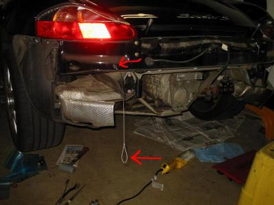

  12. ok, I definitely recommend removing the rear bumper if you want to remove your muffler to make your life much easier. Also, what the hell is the wire on the pics for???? is that to hang myself if I forget how to put everything back??? :thumbup:

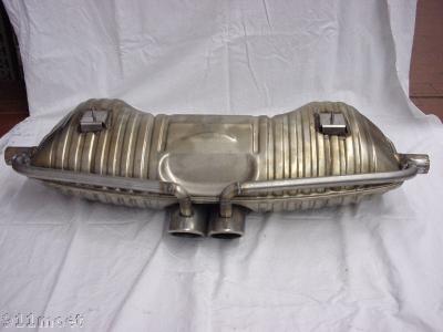

  24. Thanks, I am actually going to install the same exhaust back on the car. I just need to remove it so that I can install two by-pass SS tubes to simulate the Tequipment exhaust. See pictures from Germany maker below. I saw this on ebay but I don't want to pay over $1000 for something that can be done here in the states. i already found the tube and a good welder. The kicker here in comparison to other countries is the freaking labor. This guy quoted me 5 hrs to do this work, which equates to $300, plus $120 in material. So total is $420. It is still a lot less than most after market systems. I keep you guys posted with the results.

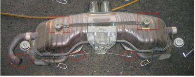

  25. thanks to all for the help provided. I got another question, i want to remove the exhaust and I want to do it if possible without removing the rear bumper. I know some of you will say that this is easy but I rather not remove it if I don't have to. So I have attached a picture of an OEM muffler with some elliptical and rectangular figures. I am assuming that to remove the muffler I will need to loosen the bolts enclosed in the elliptical shape and how about what is inside the two squares??? Do i have to unbolt anything there??? or that has no bolts??? Thanks,
