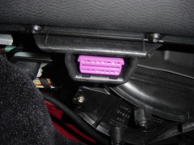

  19. Thanks guys, I have sent this info to the supplier and ordered the scanner.
  20. I want to buy an OBD reader for various reasons (including reset of CEL if I ever need it) and the company are asking me what kind of connector it uses - they pointed me to this page: http://www.ukobd.co.uk/forum/forum_posts.asp?TID=15&PN=1 Which indicates for an ISO connector, pins 1 and 15 should be in use, but the connector on the car doesn't seem to match as it looks like that attachment (pin 15 empty)....any ideas?
