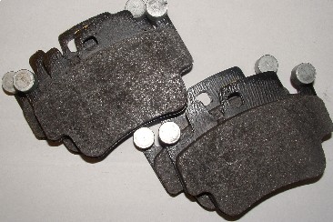

  1. So after taking the pads out and checking things out a couple of weeks ago, the click/clap is still there, intermittently, on application and/or release. Frustrating. Any more suggestions out there?
  2. Everything I've heard and read indicates the anti-squeal plates are for the Boxster "S" and not the base Box like I've got. There were none on the previous pads, just the regular flat backing plate. I took the wheel off yesterday and pulled the pads. Nothing obvious, other than a lot of dirt collected on the lube on the metal plate on the back of the pad, which I assume is normal. We'll see in the next few days...
  3. Did my fronts a couple months ago, Zimmermann rotors, Ate pads, new stock caliper bolts. No problems until I went on a 2000 km trip thru the Rockies a few weeks back (only way to see them, with the top down). At one point, I noticed a click coming from the left front, intermittently, on both application and release of the brakes. It's still there, intermittently. The caliper bolts don't look loose, and I haven't pulled the wheel off yet to have a real good look, but does this sound like a sticky caliper piston? If so, is there any easy fix short of replacing the caliper? Are rebuilt units available? Norm 2001 Boxster, 5 spd, seal grey

  11. A Porsche dealer is selling these pads as OEM. I thought OEM was Textar or Galfer without the circular ears. Anyone know what they're for?

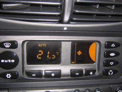

  12. Just finished the install. It was pretty easy. Took less than an hour. Meerzee's right, having done it once, I could do another one in a heck of a lot less. As far as making a DYI, with the unit I bought from Circuit Solutions (eBay), the instructions were just excellent. Step by step, with clear colour pics, and perfect English. So I'm not going to bother with making another DYI.
  13. Well, I bought one. With USPS and Canada Post combining their considerable talents, it should get here in about 3 weeks. The symbols won't be stock, but I'm getting tired of the "rising sun" and missing segments, and the price is right. Anyone interested in a full DIY?
  14. That's for the one you've got to make some mods to make fit. The one I linked to is supposed to be a drop-in. So I'm curious to see if it really is a drop-in, i.e. no chopping required. And I'm getting some conflicting info on whether the "bigger" one has the stock Porsche symbols, vs the non-Porsche symbols shown on the drop-in unit. Norm
  15. Apparently the replacement displays are now available for the Boxster that are a drop-in, rather than requiring modification. Anyone tried one? Note the symbols in the picture aren't the same as in my stock display (2001). eBay Item 280204048482 http://cgi.ebay.com/ebaymotors/ws/eBayISAP...1%3D%26_fvi%3D1 __________________ Norm 2001 Boxster, 5 spd, Seal Grey
  16. Climate control LCD display replacement Apparently the replacement displays are now available for the Boxster that are a drop-in, rather than requiring modification. Anyone tried one? Note the symbols in the picture aren't the same as in my stock display (2001). eBay Item 280204048482 http://cgi.ebay.com/ebaymotors/ws/eBayISAP...1%3D%26_fvi%3D1 __________________ Norm 2001 Boxster, 5 spd, Seal Grey Author clickman Category Boxster (986) - Common Fixes and Repairs Submitted 03/02/2008 01:24 PM

  19. How many 986 owners that have done this retrofit have had electrical issues afterwards? I have daytime running lights in my 01 986. I thought the 987 had the most problems with daytime running lights. Secondly, I understand most people are doing the retrofit on the low beams. What happens when you use the highs and then go back to the lows? Is there a pause with no light while the xenons re-ignite? If so, how long does it take? thx Norm 2001 Boxster, 5 spd, Seal Grey
