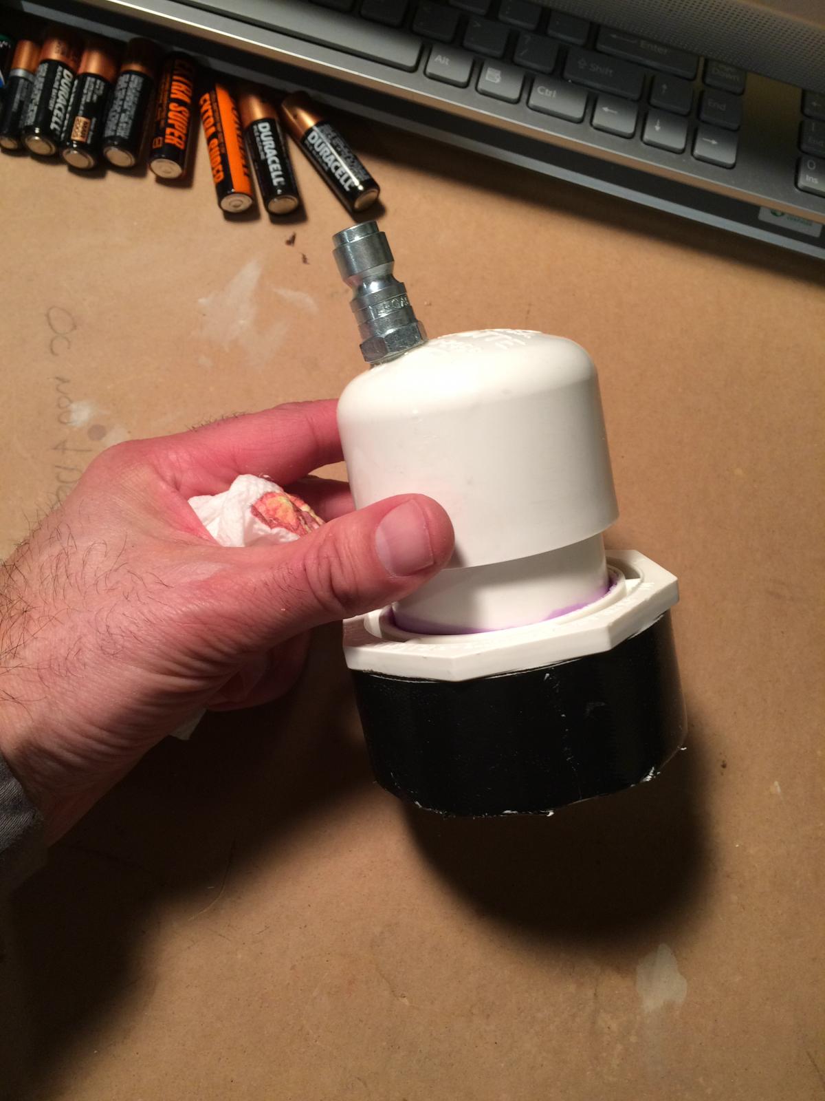

  3. I wanted to give you guys a follow up on my progress with my troubleshooting. I pressure tested the intake today with the tool that I made shown above. It worked great! I used only about 7-10 psi and unfortunately/fortunately (maybe it will fix the issues!) I had a leak. I found it with soap and water and I tried to use an inspection camera to get a better look but I still couldn't determine which part it is. The leak was from the joint of the F-pipe where it goes into the blowoff valve. Unfortunately it was the deeper valve, the one I can't reach! It figures, ughhh I can't tell if it's an issue with the rubber hose, or a crack in the valve. It appears to be leaking at the seam of the connection. What are the symptoms of a leak at that location? Would it cause the rough idle issues, or surging? Is there a way to remove the assembly (F pipe and valve) to allow me to inspect it more carefully so I can determine what needs to be done? I can't even get my hand in there! It seems impossible. I have to assume that the engine needs to be lowered a little? Any help would be appreciated. I also changed the MAF, MAP and the transmission mount today. It all went smoothly, however, I didn't test drive it yet because I wanted to fix the air leak first. Once that's fixed, I will also change the motor mounts. I will report back with the results at the end with hopes that I can help another person in the future.
  4. Today I made this contraption so I can pressure check the engine. I will post my findings as soon as I test it.
