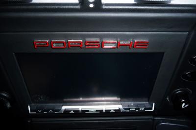

  14. And again another version. This time a Zenec 2041D. I was looking for an OEM-retro look, with knob/button ergonomics and found this unit. I removed all the Alpine modules (nav, audio processor and processor/nav interface) from the boot and installed a JBL MS-8 feeding the Alpine amps. I'm very happy with the looks, ergonomics is superb when compared with touchscreen only radios (I now found out that I hate them) and sound is actually very good, even comparing it with the previous Alpine radio. The left knob is volume, press quick for mute and press long for turn off/on. Right side knob is scroll and press for select. The UI is not as cheesy as everything else I've seen (Kenwood is horrendous) and used and it has even a discrete OEM look, with some orange over grey, ala PCM1. Nav is iGo 8.5.11 which is also a considerable step up from my previous Alpine iGo 8.3.

  21. Right, removed the door card, the lining and a good look. A pain to remove the Bose speaker box with the window glass down.... :-( Anyway, after a good cleanup of the regulator, tightening of one of the regulator stops that was loose and a bit of lubing of the regulator parts and cables and it eventually started working again and much smoother than before. In fact it sounds much better than the passenger window now!
