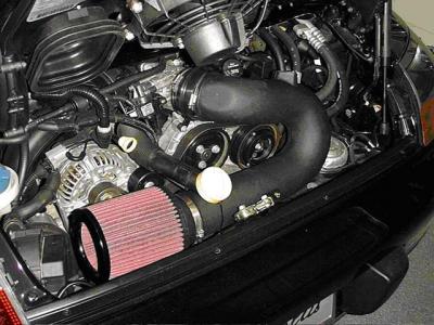

  14. Hey guys! I came across this pic w/instructions on how to build your own CAI for the P-Car. Under FAQs in Rennlist.com. Has anyone attempted this setup, it looks pretty good based on the pic (professional). I am thinking about trying it out, but confused on how to assemble to MAF to the PVC? Any feedback is appreciated. Thanks!
