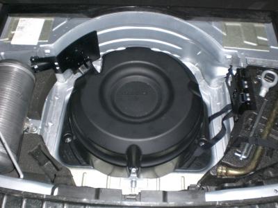

  18. On the trim around the rear door, passenger side, I saw a plastic part. I started pulling it. I have no clue what it is. looks like a light sensor of some sort. Also, I have seen that some cayennes didn't come with a spare- it was an option. I am trying to figure out whether mine came with one and/or can I put one in. Is it possible to place a spare over the woofer?
