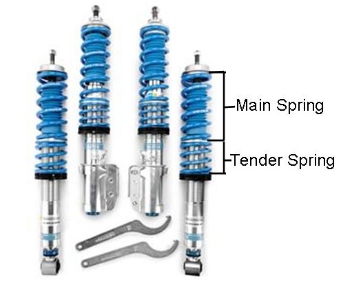

  1. I attached a picture of a sample set of coilovers with the components idetified. When you use a race spring the size varies considerably most of the time they are smaller. The tendor spring takes up the space and acts as a filler so the main spring doesn't flop around when unloaded. Spring rates can also be complicated depending on the damper and track conditions. Spring rates over 1000lbs seem to designed for race only cars that carry many more suspension components than a street or DE car. A helper spring is yet another type of spring. Any help would be appreciated. If this is too complicated just let me know. I know suspension geometry can get crazy.
  2. Loren, Have a GT3 2007. Primary use is at track day events. I run slicks with upgraded H&R springs at 400lb front and 600lb rear. Will be upgrading the dampers to Motons and stiffer springs. I am thinking about going to 700lb front and 900lb rear. When changing the springs as described above do I need to change the tenders as well? How does one determine what tenders to use with the different spring rates? I realize this is a bit complicated but can you shed a little light on the roll of the tenders Some people say put them on the top and others say put them on the bottom. Thanks Tom
