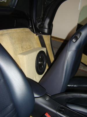

  2. 5'9" and I would agree, any taller and it would be difficult... Being 6' in a Boxster in general is a bit tough... Luckily I don't have that issue.. I am pretty comfortable, as have been my passengers so far... But if I were any taller I probably would not have been able to put the subs back there... I am glad I did though, the experience is unique, Kind of 3D as you get both sound for the ears and vibration for the body...

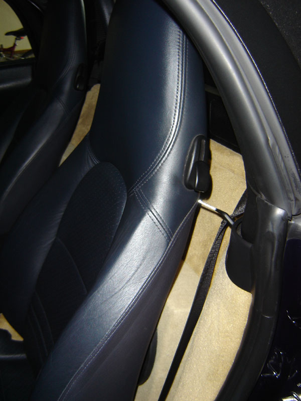

  12. The enclosures are the width of the back (door to center console) so they do not shift side to side. Also, they do fit flat on the floor (thanks to the coat hanger trick). Since the back fire wall is not just an angled flat plane (it is quite an odd shape), it would be difficult to easily seal the back of the cabinet, that is why I left them open in the back. Because of the coat hanger trick also, and the fact that I angled the front of the cabinet a bit, the weight of the sub actually forces the cabinet to the back wall, so I do not have any issue with tipping at all. I like your idea of the bottom bracket. Is there any issue with bolting to the floor??? Also, if I could get velcro to stick to the carpet, I would prefer that to any other option.... If I sell the car, I would probably take those out and replace the stock radio... Right now the way I set everything up (head unit, amp, subs) I can change everything back to original in less than an hour... That is a huge plus... What happens with the sub is that as it pushes air inside the cabinet, the cabinet may actually push forward a bit, losing some of the energy... I want to make sure I utilize as much of that energy as I can... That is the only reason I want to lock it down somehow... One thing I can do also is simply move the seat back far enough so that it touches the cabinet and keep it there (This way, the seat becomes the securing mechanism).. While I could easily do that on the driver side since I am the only one that drives it, however, the passenger side is person dependant as people always move the seat forward and back... Do you have a brand and number for a velcro that will attach to the carpet???

  15. Ok, I took some photographs... I lined the enclosures with the closest color I could find. I will eventually replace it if I find something better, but for now, they are fine. The outer material I found at a fabric store, it is not carpeting which I thought would be too thick and hard to work with. The material is a plush velvety material (not shag). Hope these help.. I showed one side, but the other is essentially the same.
