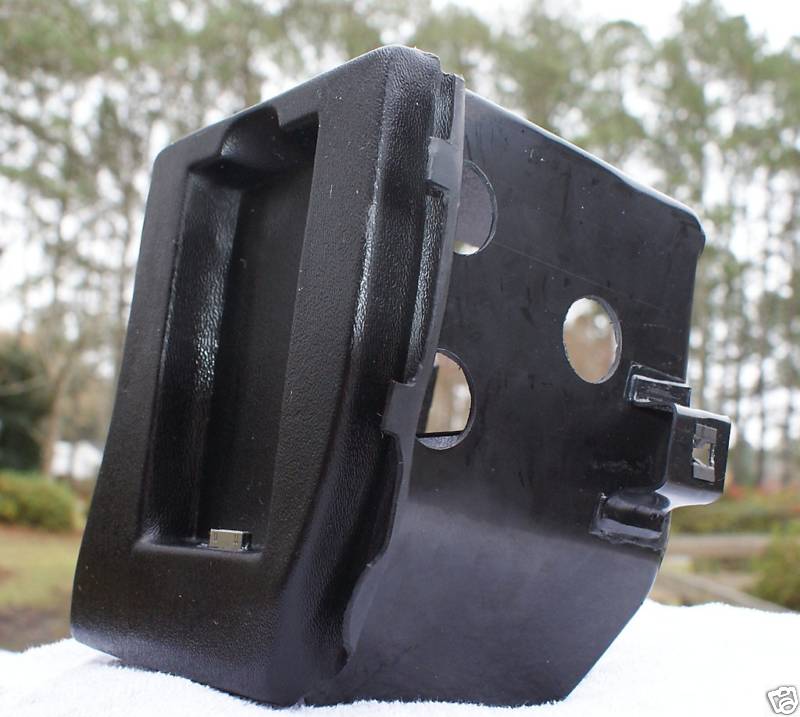

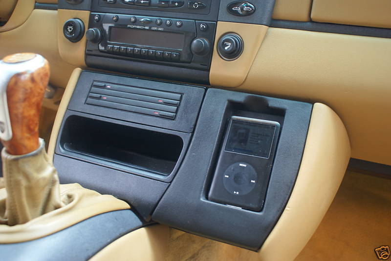

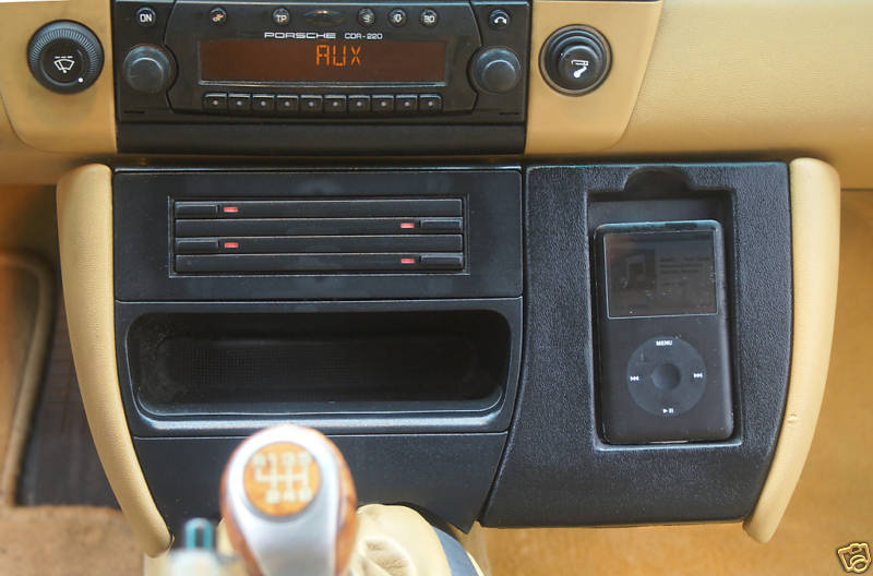

  4. good points, here's my answers to what i have read so far. my '99 carrera has no glove box so i never factored that into my design. thank you for pointing that out. if anyone can provide me with the distance from the left edge of the glove box to the center console, i may be able to make adjustments to that side. i do agree that that it does take away the symmetry of the space but trying to find a location that can accomodate the ipod isn't a simple task in a 996/986. i have no problem going back to the drawing board, i just want to make sure when i do, i draw it right. the issue regarding putting the ipod in the space of the lower center console is loosing the storage cubby. i designed and built a mockup of one for that location and when i put it in the car, it just didn't look good to me. (if i can find it i'll take pics and show it to you). i went back and made another with storage pockets on the left and the ipod dock on the right. it looked better, but was way harder to make, and due to having to make seperate pockets and then attach them to the console that i make was going to be extremely difficult. being able to accomodate the ipod touch and phone isn't difficult. the problem is only the wiring, not the design. the connectors i purchased in bulk are for ipods only (not the phones or touches). there is an adapter forsale at target/walmart that allows my connector to work with the phone and touch. no problem there...but cost.
  5. it does add about 5 inches of space to the right side of the center console. I am about 6 foot 1, 210lbs, and it didn't hinder my leg room. i orignially started out by designing an ipod adapter that replaced the upper and lower storage in the lower center console. it looked strange. it totally accomodated an ipod, charged it and played through the radio but then was a problem because then i didn't have a place to put my sunglasses, or anything else. I then moved the iPod to the right a little bit and tried adding to narrow but deep storage areas. Still looked a little strange. After some brain storming i thought of the current project that you see above. it originally was more narrow than it currently is but i found it had to be wider to accomodate 2 of the screws that were hard to get to because of the 3/4 inch depth created by the ipod pocket. if you know of anybody that thinks that this project (with or with out changes) is something interesting, i would love more feedback.
  6. i was actually hoping to get some feedback on my creation. i have designed and manufactured an ipod dock for porsches. currently it does not support the iPod nano 4G; iPod touch 2G; iPhone 3G. But that will soon change. my goal showing it to you guys on renntech is to get your feedback on what i have made and maybe determine what a good asking price would be. I have designed and built an iPod adapter that will fit in a 1999 through 2004 Porsche 911 (996), or in a 1997 through 2004 Boxster (986). The Porsche adapter is an iPod docking station that allows simple "plug and play" intergration to your factory or aftermarket car stereo. The adapter is pre-wired with an iPod connector that can allow the Ipod to play through your car stereo via a left and right RCA adapters. The adapter also has red and black wires that are the power connections. This allows the operator to charge the iPod while it's connected to the dock. Easy to install, simple instructions that a novice can follow. There's no cutting or drilling, Three small screws hold the adapter in place and screw into existing holes in the side of the center console under the leatherette panel. Instruction make installation of the panel a breeze, but because it can be used with the factory and aftermarket radios, wiring is left to the end user. Becker Radio Company makes RCA adapters that allow an aux input, or end user can run the RCA connections to the factory CD changer (if it isn't being used). As with anything, If it's beyond your scoop of knowledge please leave to a professional for installation. Made of high quality .060 inch ABS plastic. You are looking at the iPod adapter in the picture. The leatherette panel is not included nor is the center console. Does not support the iPod nano 4G; iPod touch 2G; iPhone 3G Questions or comments are welcomed. thanks again, carreraaficionado
