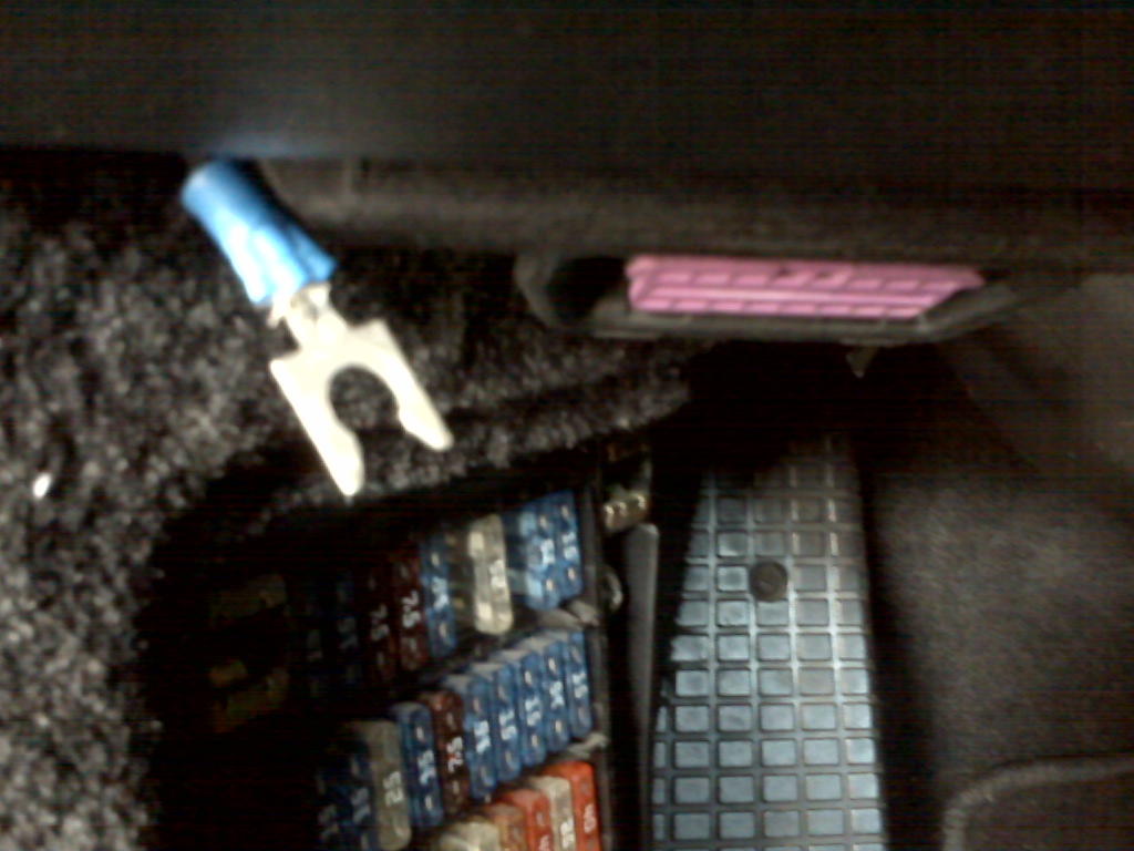

  3. wow it was the blue wire. i guess car had a kill switch before and been bypassed and that ground blue wire came loose. i feel stupid. lol cars been down for 10 days now.
  4. i put the old ignition switch back in and still nothing even with the tap under the dash. i didnt put the light switch back in but i dont think that makes a different. should i just get a another new switch? the old part # is 996 347 017 06 and the new one is 996 347 017 07. is the old part an updated part ?? (maybe it was replaced before i bought it) and i found a wire hanging out of the fuse box what is that ?
