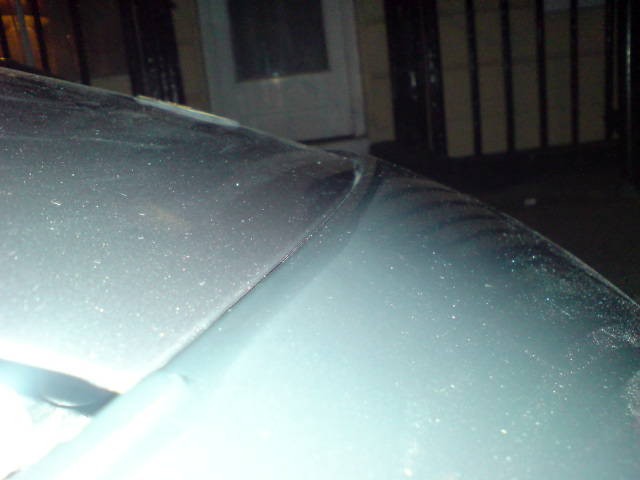

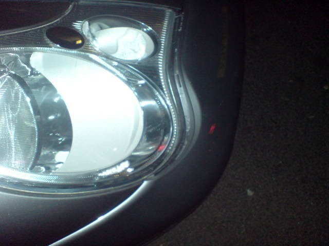

  2. thnx 4 speedy reply Loren, To be honest I dont know, as I never saw it with the bumper off. But if you mean (bumper re-enforcement = the metal impact bar behind the C4S bumper cover)...then they did not change it, as it did not really get in the way...i think....(still C2) All I know is they did'nt change anything else apart from the C4S bumper I gave them. I really dont want to, BUT I have got a funny feeling that I'm gonna have to try and take the bumper off myself, and have a look. I am hoping they bodged the fitment...and that I can correct it !
  3. Hiya All, I have just got my 996 C2 Cab, and have just had the bodyshop put on a C4S (not TT) front bumper..and it Does NOT fit right. 1) Are the TT bumpers exactly the same fit as the C4S bumpers ? (im not so sure) Can anyone help, as I have massive gaps under my lights (its like the bumper is too far forward),....also the bumper seems to be raised all the way along the bonnet join (its like it is too high or a different shape) BUT the side panel/bumper-cover joins seem to be good... Please any help...as the job looks really bad at the moment... Thanks, Michal
  4. Stickshiftz !!! thats a top idea..stickers ! Cheap / instant / cheerful. I have seen them on 996 coupe before. Im sure I can sort the lights out later on...its just that I have been living this whole import thing for about 11weeks now....And as you can imagine...."I want to DRIVE my car !" As for the FogLamps..I didnt expect them both to be fed. But that is what the Schematics said. Anyways, a new wire..not a big deal. Indicators are easy. Fingers crossed, It will be enough for the MOT man...and then the SVA man. Thanks all, Michal
