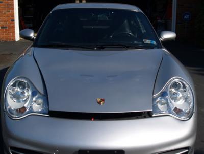

I am trying to find out how the luggage lid warning indicator works on an 04 996C2. I had an accident where I must have failed to engage the latch and a few miles down the road the lid blew open and on top of scaring me nearly to death it caused about $3,700 in damage including breaking the windshield. I have a habit of checking the indicator lights with key on and the dash indicator is not burned out. The indicator does not work with the car running and the lid open. The dealer tried to tell me that there is no such warning light but I know it worked when I bought the car because I checked it and it is in the owners manual. My question is about how the indicator light is wired. I did notice at the body shop that if the lid is open and the car locked, when I closed the hood the alarm went off, so something tied to the latch is working, but that light could have spared me from this situation.
