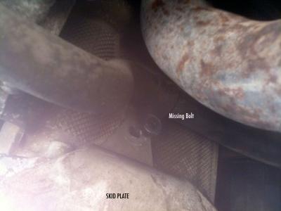

  6. Here is a photo of the missing bolt area. This is on the passenger side, behind the rear wheel. It looks to me like there is a tapped hole where a bolt could go. Should I order one? If so, anybody know the part number? Thanks, Bernard Kempinski PS. I never realized how rusty things look underneath. Topside the car is like new. Maybe it's time for a Stainless Steel exhaust?
  7. Thanks for the info. The dealer told me that the skid plate is aftermarket. He says that Porsche did not offer one in my model year. A previous owner must have installed it.
  8. I recently brought my 2002 996 Targa, 6 spd manual, in to the dealer for service. When it came back, I was inspecting underneath and I noticed a bolt missing that connects the skid plate and another component to the transaxle. Do you have to remove the skid plate to change the oil?
