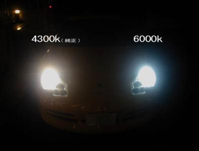

  2. I changed bi xenon headligh bulb to 6000k. It was easy DIY. Here is the comparioson photo. The right bulb is original, and the left is 6000k third party bulb which is bluish. Note this is not intend to modify brightness of the headlight, but the higher temp bulb seems to be more bluish.
