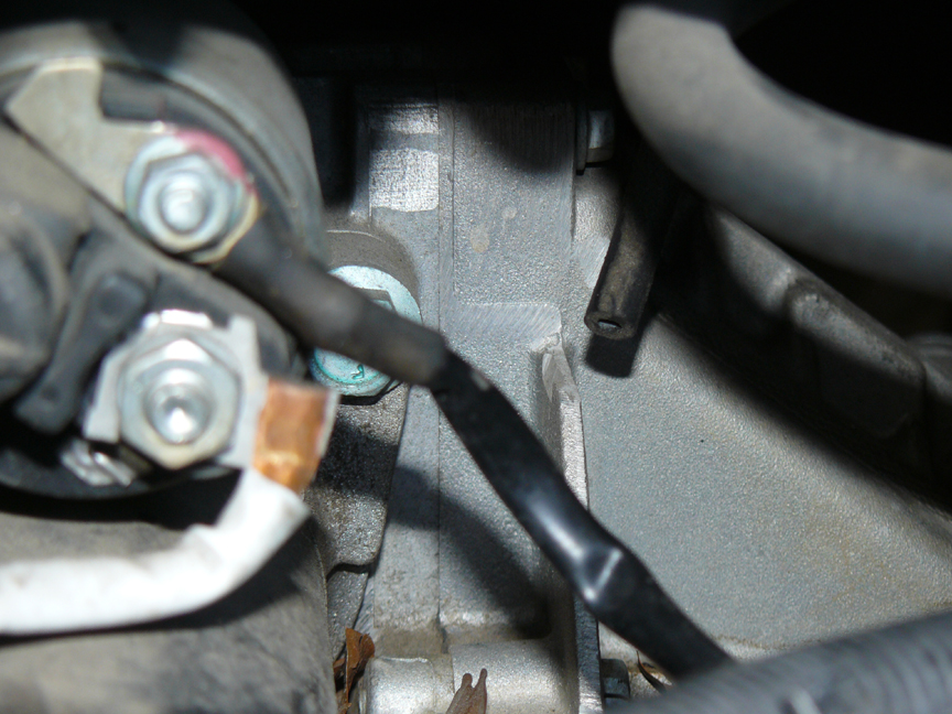

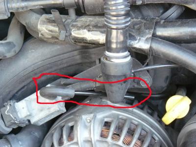

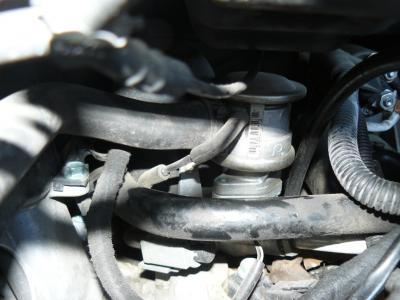

  23. Thanks for the replies...I removed the alt, and TB and the only thing that looks like it is missing a tube is a hose at the very rear of the engine to the right and farther back than the intake crossover tube and starter. (See pic). If this is it do you have any suggestions on how to reattach a flimsy line to a arubber tube that is almost impossible to get my hand on? Is it important? Can I just cap the platic line? The 2nd pic is of the valve behind the alternator it seems to have all the lines attached.Thanks again.
  24. After I changed my oil tube I foiund this hose is no longer going where it is supposed to go. Can anyone tell me where this line ends?
